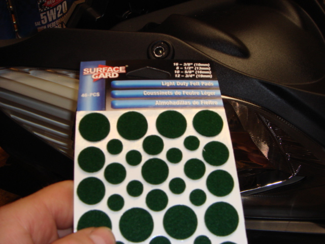

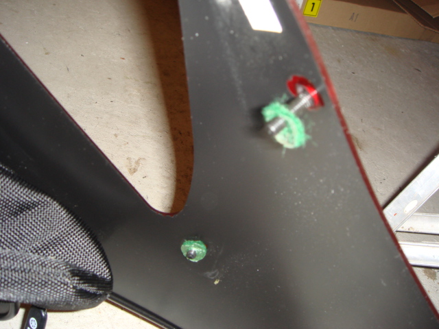

Ok guys,..
I installed some other things today and had time to mess around with the windshield bag...
I highly recommend doing something similar to what i did,IF you dont want to see your chrome all worn away the back of shield.....
The plastic tabs are large on the window bag and they rub.....one reason is cause the tabs are not placed very accurately which makes the bag LOOSE and lets it bounce alot...also,the tabs are long and square at corners so they rub badly on chrome on backside of window which will rub thru to front and you can see it.
here is my solution...pics to follow..
first off,cut OFF the plastic tabs at the existing holes...they are far too long!....then shape the plastic tabs to round them off and clean them up so they are smooth...i just used metal snips to trim.
now,go to home depot and in the furniture section,where they have the foopads for sliding furniture around..you will see some FELT sticky pads..these i believe will work well.
i installed the pads on the shield bag and ALSO on all the screws where the window meets rubber darts....so basically on the back of the shield...they all had shown signs of wearing off my chrome and sled is only 1 season old...so i recommend felt on ALL.
it all turned out great...shield is back installed and fits nicely,as the felt is compressed perfectly as i had planned....also,the shield bag is nice and snug.
pics below.
dan
