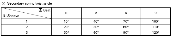

As responsive as 8ES when empty(no rivets) & +10 degrees in secondary.

aVenture
What do you mean +10 degrees on secondary?
I came over from the doo camp and don't have much experience with these clutches.
thanks
thanks
dooboy600
Thanks aventure
Si is 10 degrees more or less than stock?
