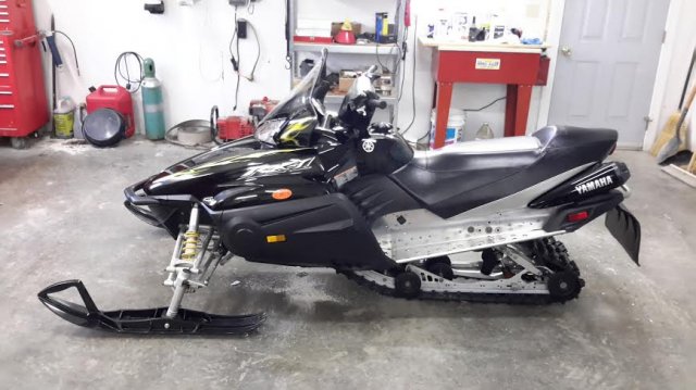

I have the wrp seat instaled and i tried it today. If you are on the fence about this seat, you dont know what you are missing. Go for it. I also instaled a 3 plus inch pivot riser and a cable extenion from powermadd. This is on a 2004 rx1 shorty with m20 air, 2016 tunner skis. I no longer have plans to trade for a new sled now, thats how big a difference this all made. All for under 700 dollars, minus the m20. I am sure the difference is more profound for me because i am 6ft 5 inches tall and 300 lbs. Over 200 miles today and i have zero leg and knee pain. Thank you wrp for an awsome product. Thank you totallyamaha for an awsome forum!

All done! For now.
