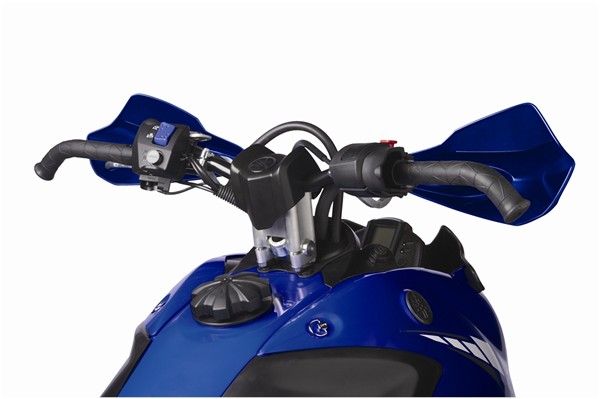

Seen the xtx this weekend and the risers on it are a joke. we got screwed. rtx and xtx risers are not interchangeable....i might go and spend $$$ on a set of rox risers if available!!! Yamaha isnt a real big help.

I brought this exact issue up months ago. This sled is a long tracked standard Nytro, not an RTX. How did you guys buy a sled without knowing how its spec'd out. Looks like Muffinworks has you covered with the riser, but you still didn't get the RTX shocks.
7th post down from the top.
fxnytrortx3
the RTX and the SE both have the pivot riser system already. the rtx is an 08 but it is the same anyway
the xtx and std nytros have the traditional system with no risers at all
the mtx has the traditional system with a riser block
hope this helps
hope this helps
towerrigger
The MTX also has a different steering post as I found when trying to install the stock MTX riser on my RTX. The MTX has a flat plate with 4 holes in it that the riser bolts to and the RTX has the bar as seen in the pic above. Just a heads up for anyone thinking to do the same!

the MTX Riser and post sucks BIGTIME...don't know WTH Yamaha was thinking when they installed it...The Standard and XTX isn't to bad to get to work...the RTX is a pain in the A$$ to install a different riser on alsto, because the T-top is so narrow, it looks stupid when changing bars and risers on it... I've never found a single Yamaha with thepost I want, so aftermarket is where you need to look...

Looks to me the bars are differant!!!!! the hight of the top of the hand grips dont look much differant from the XTX to the SE

fxnytrortx3
that is true but the style of riser on the se you can pivot the handlebars more than the xtx so you could swing it towards the windy to get more height. if you know what i am talking about

I like the RTX & SE pivot steering post alot more than the Std's and MTX's and X-tx's flat plate.
fxnytrortx3
ya they are nice because it gives you alot more room for customizing the bars and how you like them.
