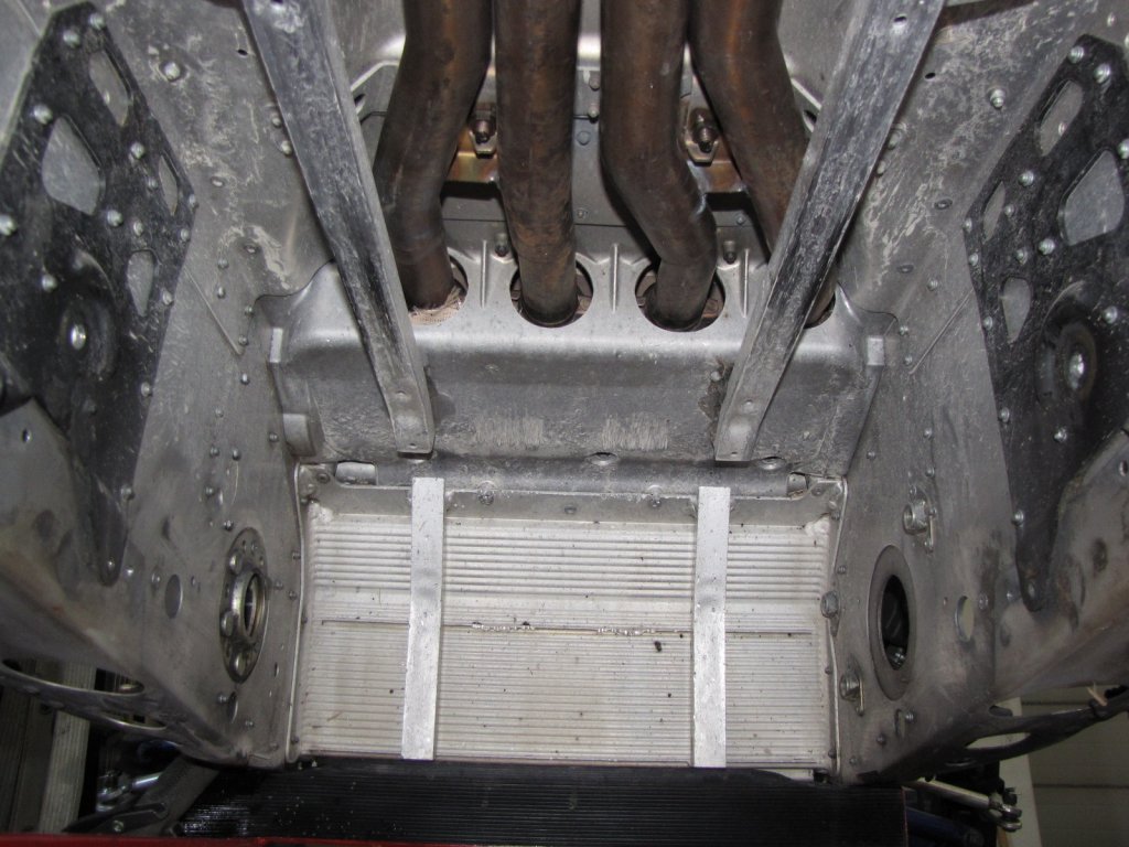

Ok, not out of the woods yet! Y Pipes unbolted, bracket bolts are stripped out so can’t remove them, I drilled out the bracket and now how do I remove the Y pipes, is it saw saw time and I end up buying new bracket, how easy is it to saw saw the pipes, ?
Looks like they should slide right out once all the rivets for the bracket are gone. You may need to remove the tunnel protectors but not sure on that.
jclee71
The pipes are still attached to the bracket due to the heads of the dreaded allen bolts are rounded out, the bracket is free as i drilled out the rivits but as a whole unit i cant get it out from above the tunnel protectors and i really dont want to remove protectors
jclee71
I figure i can try to drill out the allen bolts but i was hoping to leave them so i can remove them with vise grips later and salvage the bracket

Drill the heads off them 2 bolts, then unscrew them from the underside,I figure i can try to drill out the allen bolts but i was hoping to leave them so i can remove them with vise grips later and salvage the bracket

Edit: Just read in your first post that you did. I also had to remove the bracket due to the bolts stripping and did not remove the tunnel protectors after drilling out the rivets. That was quite a while ago as the Apex now has over 18,000 miles and since then I've also had to replace the titanium headers with SS ones. If your existing headers are damaged and already have replacement ones, then worse case scenario you get out your saw.
