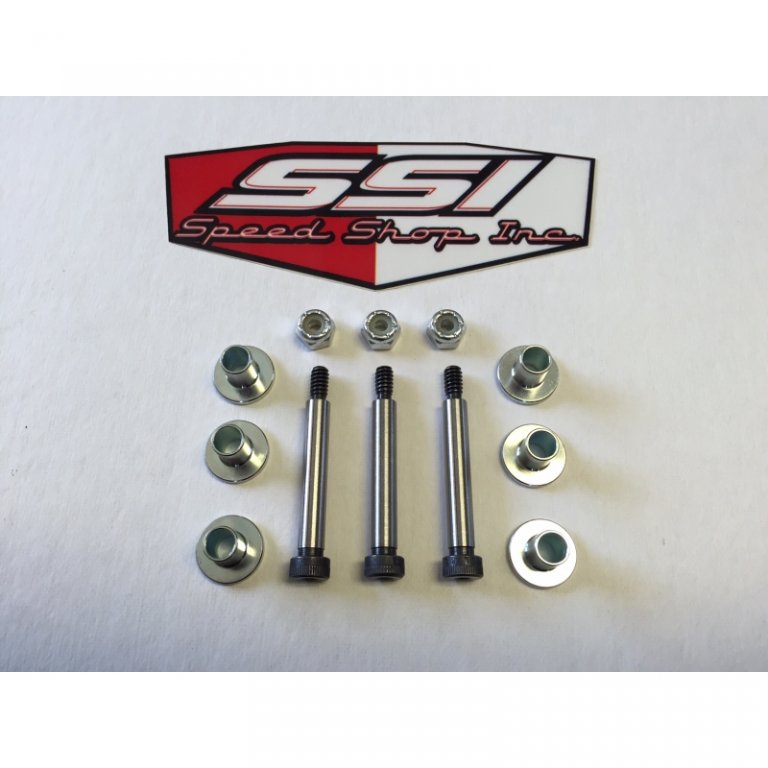

YAMAHA CLUTCH WEIGHT CONVERSION KIT
This simple kit is designed to convert your Yamaha YXR clutch so that it can accept the Polaris, Arctic Cat and Comet style weights with bushing for the pin.
The kit comes with machined spacers, pivot pins, and nuts.
Anyone here having experience with the above ?![]()
Thunder Products Clutching has been doing this for years and is very popular with the lower CC sleds running our TSK weights. They also work for our heavier weights for Arctic Cat and Polaris.
This is Thunder Products Clutching TSK-250 weight kit, but you can also get the pins we use and they are TSK-540
They also work for Arctic Cat and Polaris flyweights.
You can get the pins we use and they are part # TSK-540
Sounds great !...but what about this "tower bushings" that seems to be needed ?
1. What physical weight should I start with ?
2. What happens to the shift characteristics when the profile/curvature of the TSK or Polaris flyweights differs so much compared to Yamaha flyweights ?
