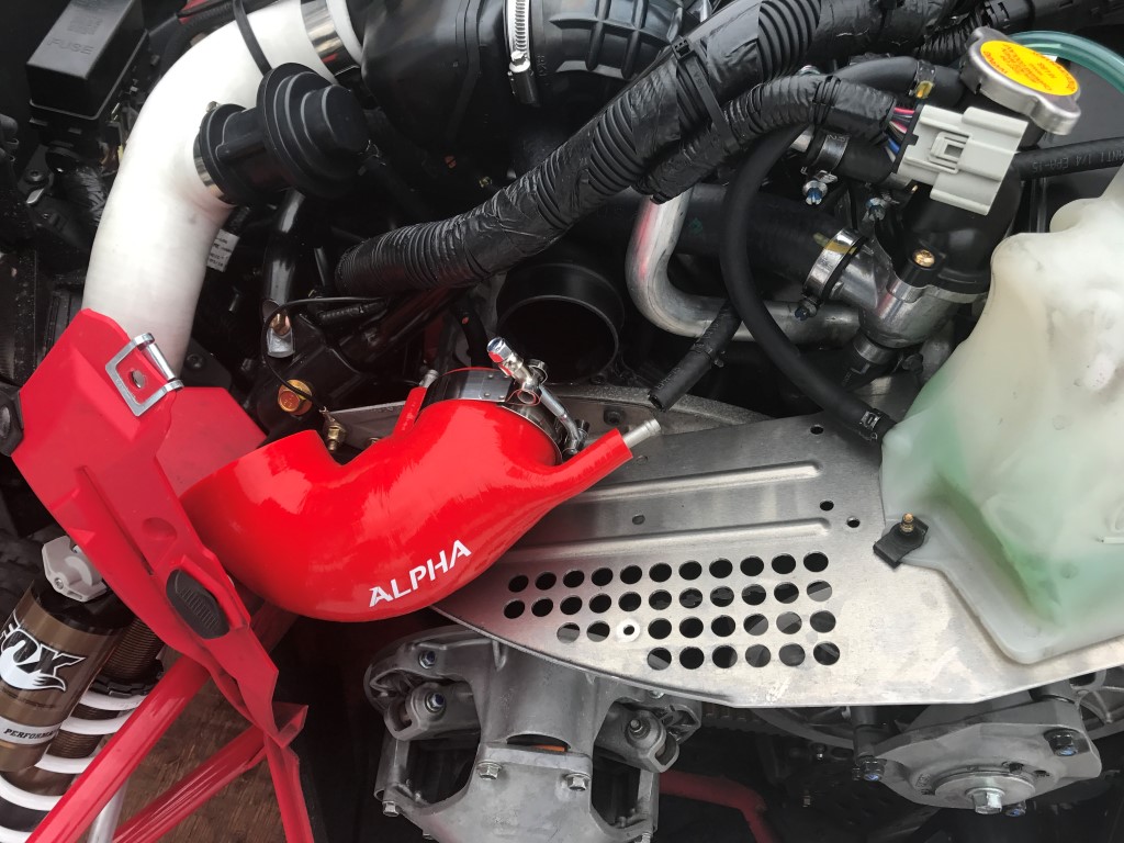

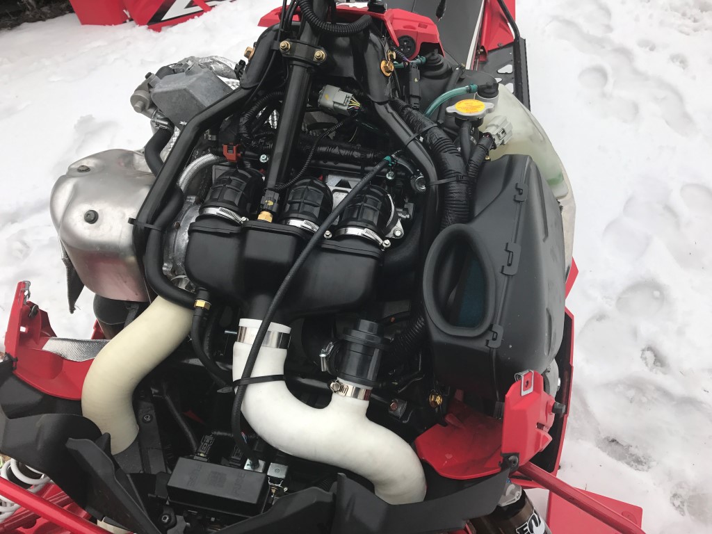

I decided to add the cold air intake to my SideWinder from Alpha PowerSport
Currently running the Stage 3 Evo Flash and added a K&N pre-filter #22-8044PK from Ulmer Racing.
Fairly easy install.
I added clamps on the rear and front nipples of the Alpha intake to secure them in place when pushing on the hoses from the sled because the nipples wanted to push in. I also added a pre-filter to the intake filter, this is not provided from Alpaha. I like the idea of keeping small participle and belt dust out of the turbo.
- Remove Side Panels and unplug hood harness, removed hood.
- Remove the 3 Torx Screws from the underside through the belt guard.
- Pull back on the intake box and it will pop off the main intake tube.
- Pull out the rear tube that comes from the motor valve cover. This will need to be shortened to go onto Alphas rear nipple on the new intake.
- Remove the front clamp and pull this off to the side. This will go on the front Alpha intake nipple
- Put all the parts in place, lightly attach everything but do not tighten the main clamps until you have it in your desired location. I would also suggest putting the pre-filter on before sliding the filter onto the Alpha intake plenum.
