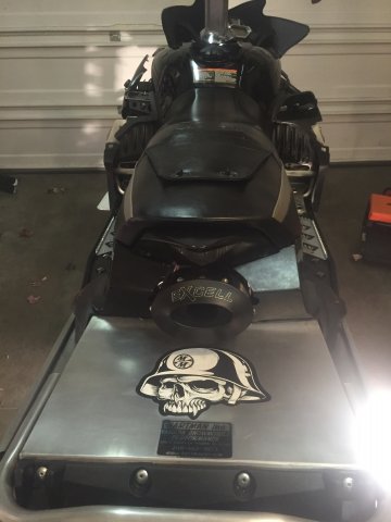

Mods
hartman 136 extension,1.5 intense track, extro drivers, 23 tooth top gear,all shocks rebuilt at shocktec rear revalved,dalton clutched with custom helix, mtx riser, ddm hids,oilite bushings in front, c& a ex skis,pioneer bigboy spring, copper donuts, mbrp headpipes, excell muffler, pc 3 and ign module, duponts, larger battery,yami heaters with thumb boost,intake drilled out with frogskins installed, yami floor board supports, front a arm beef up ( made and installed by me!)
Comments
Great looking sled. I have the same one. It looks like you put something on the runner boards where your feet go. Mine wear through the paint there pretty fast. What did you install?
thanks, they are yamaha tunnel reinforcements, you have to order them for a 2011 apex if i remember right and up but they fit perfect and stiffen the board to save your exchangers as well, they were only like 100 bucks and come with rivits, think i got em from yamahasportsplazs. com!!
