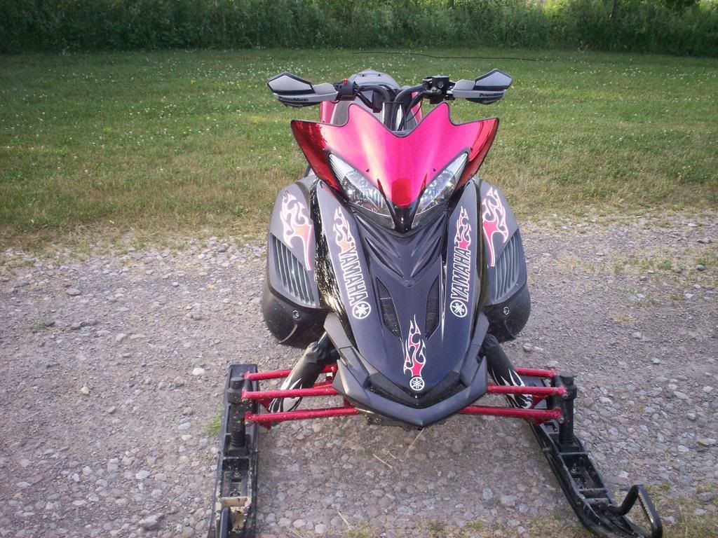

hey jeff this mike , sry havent called mine on call this week. any way good start is skid plate. i also have 23 t gear . accerlation is awesome out of hole with 23t gear. i was riding at in laws today in attica. for skis i just put woodys dual on mine sled. heres couple pics of my sled
Hey Mike - Looks Sweet. I like the ArcticFX graphics. The place I bought mine took off the graphics on the side panels, so might have to do something there. Can't wait to ride and see you out. It is gonna be a fun winter and interesting seeing how me and Woody made the switch! There will be more to follow!!
