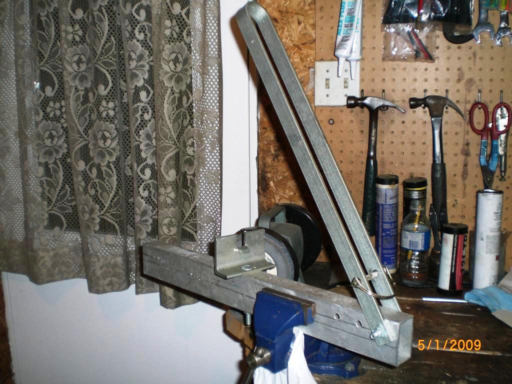

Here's a pic of the shock with spring removed you'll notice the 3 "C" clip settings, stock is at the 1st nearest to end so the further you set it towards the centre of the shock the more you compress the spring....for any help on settings like mentioned we need more info on rider weight with gear if possible, if you lived a little closer I'd take your spring off, I made myself a spring & shock PRESS.

do anyone know what to do or tell me where to go to so i can see how to remove the shock with the dial on the side.
harm67
Check the FAQ sticky at the beginning of this forum look under suspension for multiple shock removal suggestionsApex2006RTX said:do anyone know what to do or tell me where to go to so i can see how to remove the shock with the dial on the side.
Apex2006RTX
How do you release the shock once it is compressed?
