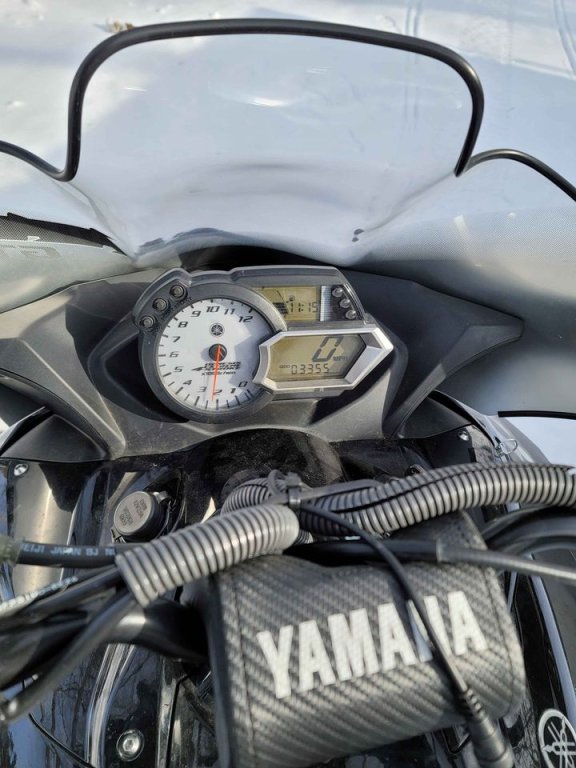

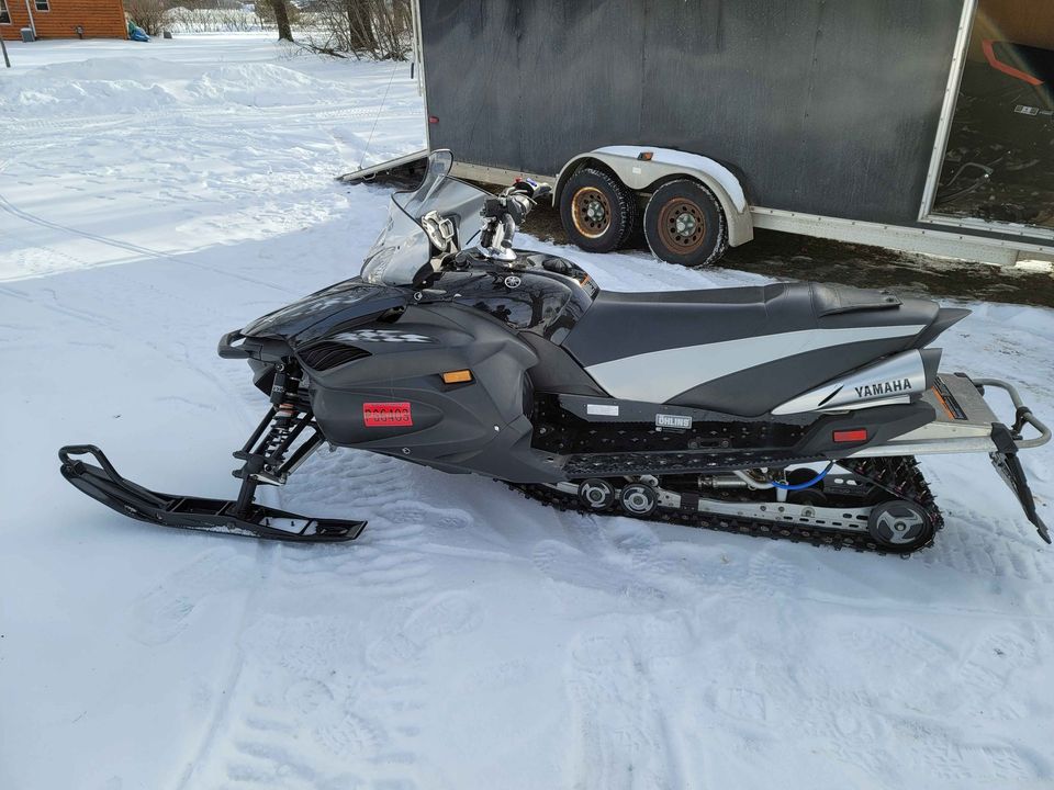

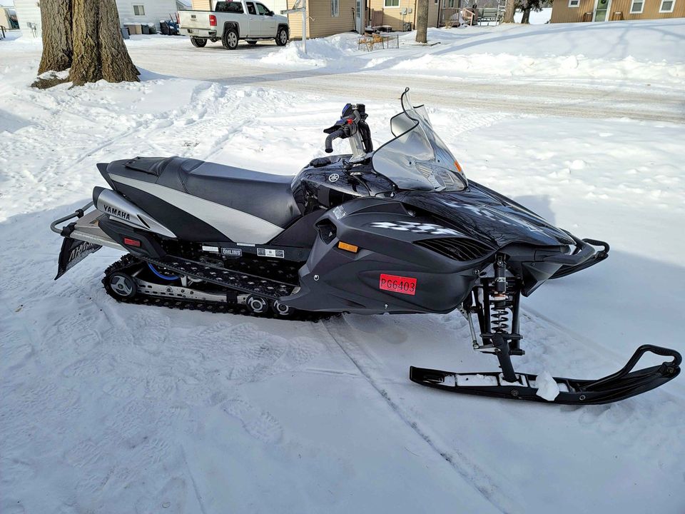

So going to close this thread out...... Decided against the 8100 mile attak that was 10 minutes from my house. I found a one owner 07 Attak GT in the Detoilet area with 3300 miles, the sled is immaculate inside and out, paid 3k for it , it took a 500 mile round trip but it was worth it...... Now to pray to the snow gods
Thanks for all the replies

Nice looking sled. They are a bit of a pig in the tight twisties, but in a straight line or on a lake, they go.
