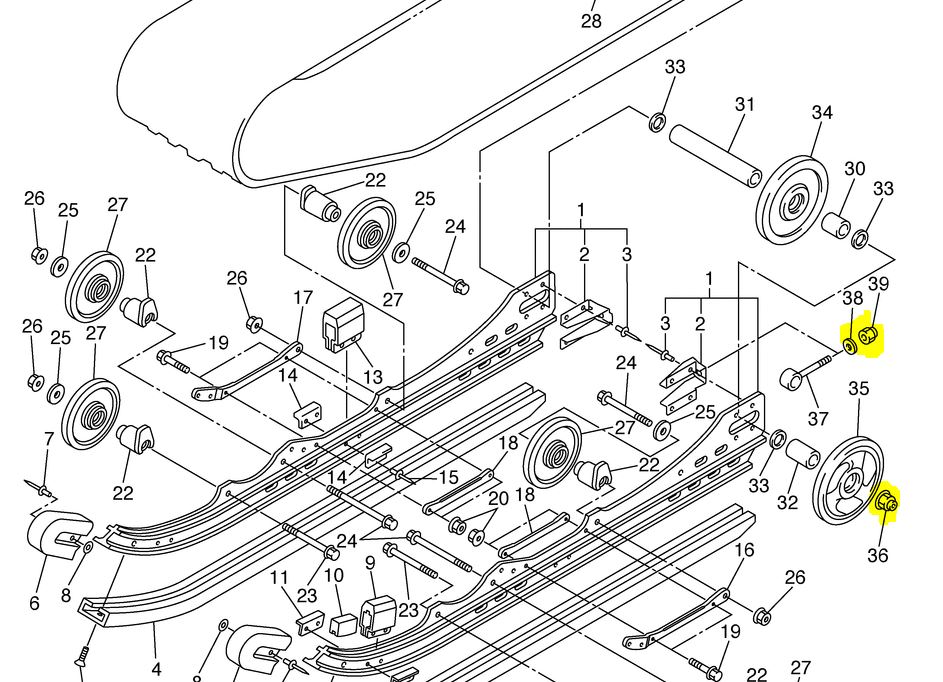

Not only is Port Yamaha an awesome vendor to deal and work with, but they also have the parts micofiche which can help in times like this to see how something is fastened together. Other Yamaha dealers have this on their website but there's only one Kevin.
Like 74Nitro suggested, you need to have the drive axle bolt (#36) loosened as well as those two rear track tension bolts #39.

ahh yes that did it, thank you!!
