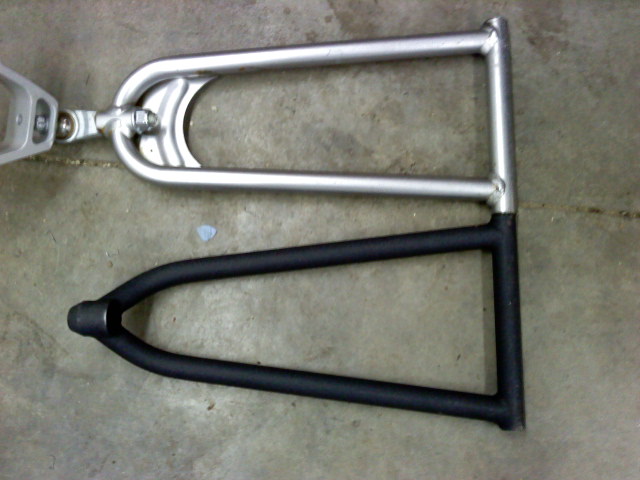

AK...
Hey AK here are the pics you wanted. The arms are basically the same diameter as far as the tubing goes. All chromoly (stronger than stock). Biggest difference i can see is where the shock mounts. It is much closer to the center of the sled.

Right on! Thanks for posting some pictures. Are the pics of the LH (as sitting on the sled) upper and lower a-arms? There definitely looks to be some geometry changes with the angle of the upper heim joint. Geometry changes to the lower a-arm are more difficult to see because of the shape and bends in the tubing.
I like how the spindles are boxed on the outside. The kit looks to have used different lower ball joints and upper heims. Did the 43" kit come with longer tie rods?
As far as the discussion about widths go. I'm thinking the 40 and 43 inch widths are Zbroz marketing strategy to set them apart from the other kits. The stock width of a short track Nytro is 41.3".
You'll have to post some pics of your completed project! I think the black front end is going to look good.

AKrider said:Right on! Thanks for posting some pictures. Are the pics of the LH (as sitting on the sled) upper and lower a-arms? There definitely looks to be some geometry changes with the angle of the upper heim joint. Geometry changes to the lower a-arm are more difficult to see because of the shape and bends in the tubing.
Nope the stock tie rods work just fine with the 43 in kit. I didnt know the exact dimension of the stock front end but i compared the two arms and seemed to be an in or so difference between the 40 in kit than my stock, so thats why i went with 43. You can use all the stock stuff with 43 as far as tie rods and shocks and sway bar.
I will def get some pics up here with the completed project. should be cool, got the black front end. white windshield, blue cowl getting some white graphics put on it today, steering relocator, and mountai assault black and white seat!!
