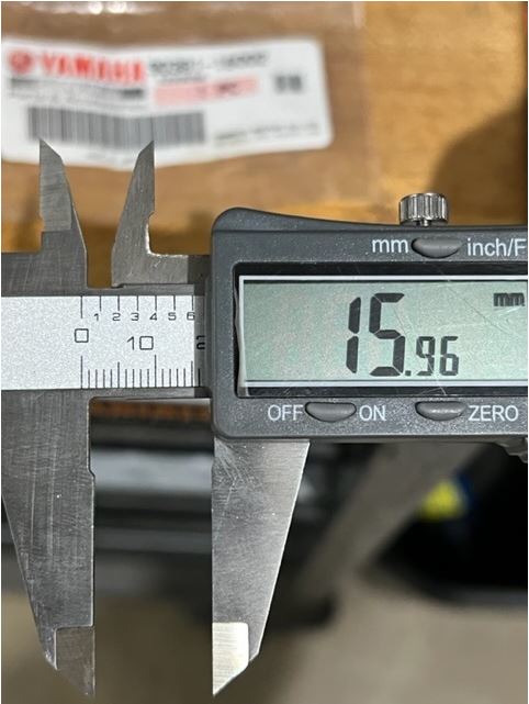

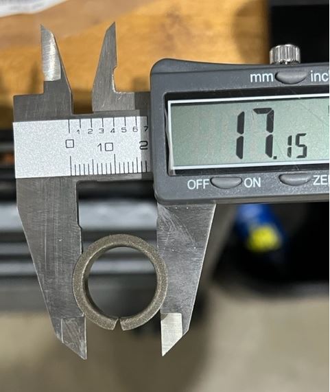

Thank you some much for your time to provide these dimensions! I am out of town on business today but will be home tomorrow to check these dimensions. Thx@Gone Blue Here you go. Let me know if you need different measurements. Digital caliber is nothing fancy so assume some variance with these numbers. The picture without the bushing is what I was able to sequeeze the bushing/pinch in that gap so as to provide a collaspe measurement:

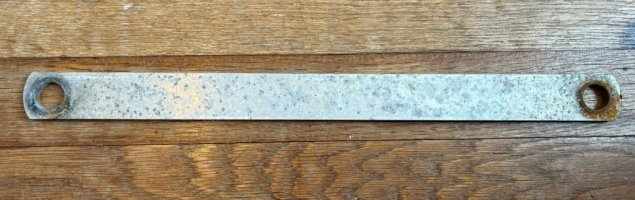

You will find that the bushing holes that the bushings sit in the aluminum relay rod will be egg shaped and worn. Barn of parts has steel relay rods with the Yamaha bushings installed in them. Better for long-term use.

RobX-1 those bushings should work in the Nytro link arms! The OD of the steel Nytro spacer that fits into the bushings in the link arms, measure 16.05 mm. Thanks again for posting the dimension. I have one hole that is a little egg shape that I may try and wrap some thin aluminum or brass sheet material around the new bushing. Thx GB@Gone Blue Here you go. Let me know if you need different measurements. Digital caliber is nothing fancy so assume some variance with these numbers. The picture without the bushing is what I was able to sequeeze the bushing/pinch in that gap so as to provide a collaspe measurement:

So these bushings (#90381-16002) fit the stock Nytro transfer arms. However,I noticed that (1) hole in each arm was slightly egg shaped. So instead of drilling the egg shaped holes round and wrapping brass shim material around the bushing, I placed a new bushing in the egged hole and used a putty knife to press metal JB Weld into the clearance areas of the bushing and the egged hole in the link arm. The picture attached is after I pressed the JB Weld in the clearance around the bushing. So, I will see if this holds up? GB.....@Gone Blue Here you go. Let me know if you need different measurements. Digital caliber is nothing fancy so assume some variance with these numbers. The picture without the bushing is what I was able to sequeeze the bushing/pinch in that gap so as to provide a collaspe measurement:
