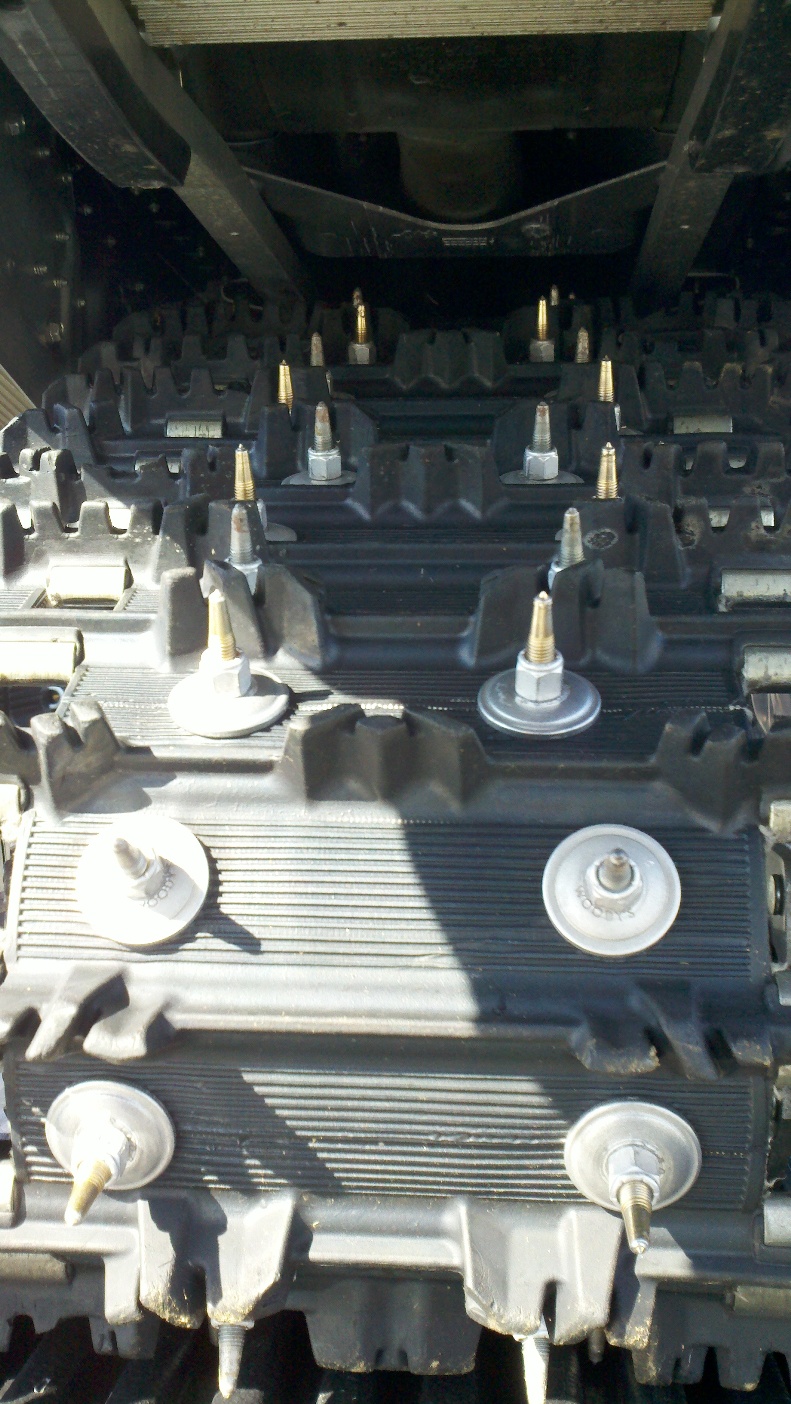

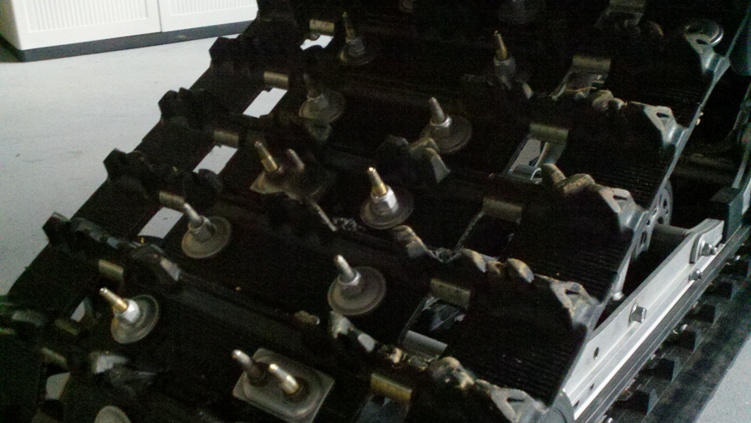

Took my sled back to Woody's Yamaha in Maine ( Were I bought it last year) And they put the other 54 pics ( 108) total that I asked for last year when I bought the sled. Dan ( Salesman) didn't skip a beat in honoring the agreement even though it had been a year! Now I will add the other 60 totaling 168. I plan on adding some double backers every other paddle.

For best hole shot you have to stud the outside belt and avoid the center of the center belt. ( I ran four per window on my Attack with a couple other trick's) And to turn I run the aggressive SnowTracker's, and it only requires a bit more arm at slow speed's with NO hunting or darting. Three regular carbide trail stud's per window would probably be fine using the outside belt and avoiding the center of the center belt.
I am thinking of adding 27 doubles ( adding 1 more side to side of current studs) every other paddle and than 1 on outside every other paddle alternating sides? That would bring my total to 162? What do you guys think?

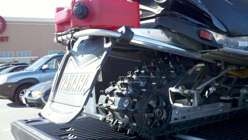

Done and ready! fresh Engine oil change and gear box oil change , Chain adjusted. Headlights adjusted,Fresh grease and ready for snow!
