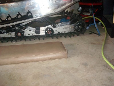

I would go with the OFT tipped up rails and I would install a extra wheel right before the tip up. If you put on the dupont hyfax ice scratchers will not be needed. I would take off the protectors. Anti racheting drivers would be a good idea also so you can run your track looser. How set are you on the 1.5" track? After puting 2500+ miles on my backcountry I really think it's the way to go. Just my opinion and what I did and love how it works and handles.

I wouldn't waste your time with the 136" just go with the 144". A xtx doesn't have anything different than a standard short track for cooling. I really would look into the backcountry track to. It hooks great on and off trail. My sled was a studded 121" and thing handles 10 times better with the longer skid and tipped up rails. For a extra wheel by the tip up part of the rail I just picked a set of outside mount kits from Yamaha and you can use the small yamaha idler or skidoo which ever you can find. Btw my stock clutching and gearing worked fine.
