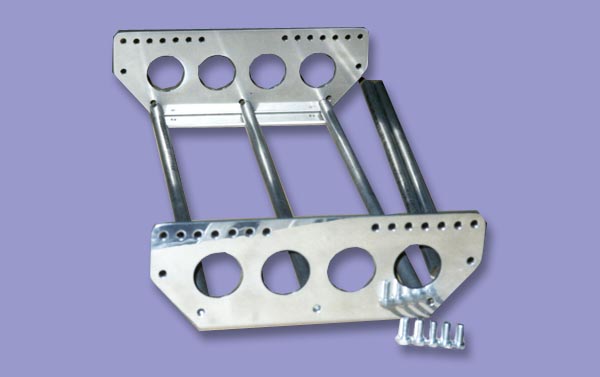

I just put a 16" wide track in my 04 RX-1M. Very tight but it does fit. I shaved all 3 chain case bolts and put a lag bolt in the one chaincase bolt that the track runs over. Worked great. I think that was tundras idea. I also made 1/4" 6061 aluminum drop down brackets. I did this to put an AC skid in which also made it so the track would fit. Like LB stated, the 2 main things you have to change are the drop down brackets and the chain case bolts.
