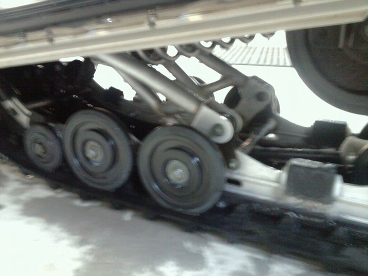

Rx1 wheel updates
Check out www.schmidtbrosmotorsports.com They do the cold air box mods and rejetting. I have an 05' Rx1 with about 2300 miles on it. I didnt have the air box mods done but I had them install about 4-6 more boggie wheels underneath the suspension where they need to be. 2 in the front arch rail. 1 to complete the 4 in the back axle. 1 on each side in the rear 2 inches ahead of the back axle and a few in between. Theese wheels will cause you to do a lil re clutching which he does before you get it back. Your not dragging your slides anymore, everything is free'd up and that alone is about 5 hp. Im throughly impressed.

Got a pic of that setup?
factorystock70 said:Check out www.schmidtbrosmotorsports.com They do the cold air box mods and rejetting. I have an 05' Rx1 with about 2300 miles on it. I didnt have the air box mods done but I had them install about 4-6 more boggie wheels underneath the suspension where they need to be. 2 in the front arch rail. 1 to complete the 4 in the back axle. 1 on each side in the rear 2 inches ahead of the back axle and a few in between. Theese wheels will cause you to do a lil re clutching which he does before you get it back. Your not dragging your slides anymore, everything is free'd up and that alone is about 5 hp. Im throughly impressed.
factorystock70
2005 Yamaha RX1 wheel kit
Ok, here it is.
Ok, here it is.
