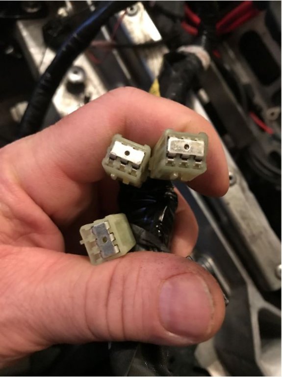

might need to clean the ground blocks in the harness or at least check them. known problem area on these sleds.

I just noticed two things when trying to start it. The Red oil pressure light is not coming On anymore when I try to start the sled. It should come On until the engine starts and builds up enough oil pressure and then go Off, right? Second, when the engine is cranking, but not starting, the RPM reading jumps all over from 0 to 20 to 200 and repeats. while I think it should be around 250 when the engine is cranking. Any ideas what could be the problem ? Thanks!
RobX-1
- 2,592
- 1,758
- Coldwater, OH
Sounds like electrical gremlins so I would start with maim's suggestion of checking the ground blocks located throughout the wiring harness. Just start at the top of the steering post and look for square blocks wrapped up in the electrical tape. Here's pics of the ground blocks from my 08 Apex just to give you an idea as to what you are looking for.
