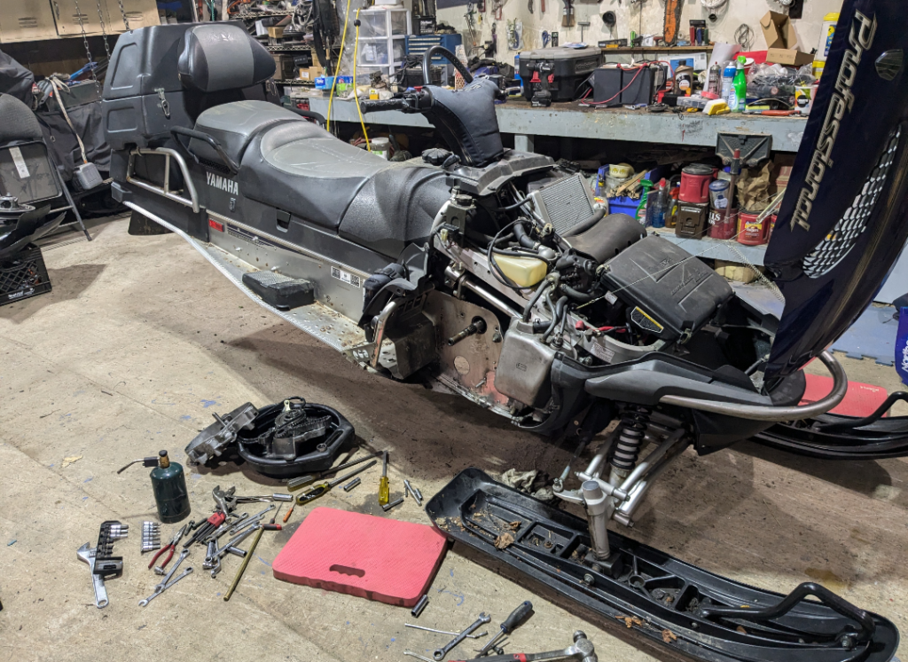

Alright, secondary is off, rear skid is out, chaincase is drained.  Hope to get the cover off tonight, ccase guts out, speedo housing removed and driveaxle out tonight.  Going well so far, pretty good to work on.

Well the drive axle is out and headed to the shop for sprocket installation today.  The entire chaincase had to come off to get the axle out, but it was not hard to do.  Literally 4x bolts once the cover and guts were out.  There are a lot of spacers, shims and washers in there, hopefully I can recall reassy order... Parts fiche is on the bench just in case.
The drive sprockets have no signs of melting or slipping on them, All gears in the chain case look to be in good shape as well as the chain. One thing I did notice is the chain did look to be a little looser than I would like and that is possibly the source of some of the ratcheting. I will pay particularly close attention to that on reassembly, going finger tight and back a half turn.

Rough sight lol.  Hopefully get the drive axle back next week with the anti-ratchets on.
