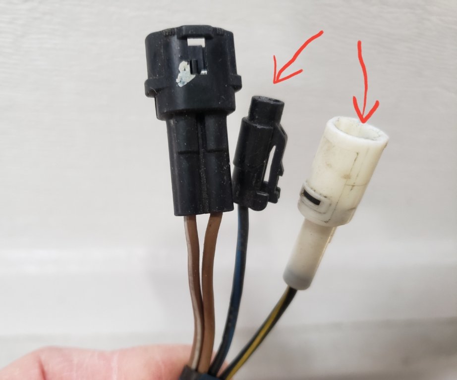

Randix11
- Feb 26, 2022
- Mtl
- Yamaha Phazer 2010
Hi, could someone help me locate this wire on a Phazer GT 2010. I'm trying to help my father who has the snowmobile with him. I'm guessing it's on the right side? Do you only need to remove the Right side cover or also the Right lower cover?You could unplug the two single wire connectors getting the throttle block assembly (TORS wires) and plug them into each other on the engine harness side. This will bypass TORS for testing purposes. This is not recommended as a fix as it could result in bad things happening if the throttle ever stuck open. Just be familiar with the kill switch location during your "testing" phase.
Thornton3280
- Dec 30, 2021
- 31
- 138
- Sobieski wi
- 07 yamaha phazer base
They are on the battery and oil tank side should be 2 plugs one with a single white wire and one with a single black wire just follow the wiring from the handle bars
