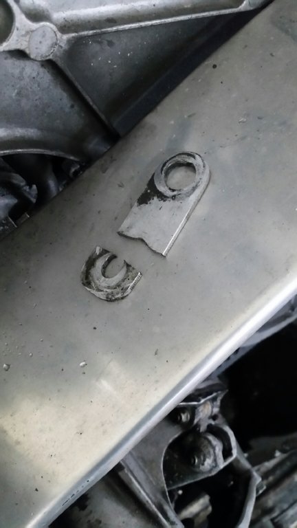

Well, I'm very happy to say that I figured out what the problem was!
Having the boost gauge hooked up was the key. I noticed that when it was acting-up, the boost was dropping to around 10psi and the needle was fluttering. So I knew I had a boost leak. After a while of just sitting there looking at everything that I could think of, I found a little aluminum bracket which was broken. It connects the inter-cooler to the frame on the left side at the top. When boost pressure got high, it would blow the inter-cooler with throttle bodies attached back off the cylinder head enough that the boots would leak. When I let off the throttle, vacuum would pull the boots back tight up against the cylinder head.
Still not sure why it was fine when going down the trail...
Anyway, I put a couple of zip ties around the bolts that attach the bracket, and spent the rest of the day with full power and no hiccups. Most fun I've had riding in a while!
I'll attach some picks of the broken bracket. I forgot to take a pic before I removed it. I'll also attach a GoPro video of when it was acting up. Hopefully it will help someone else so they don't spend as much time wracking their brain as I did.
