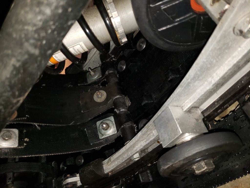

What model sled. I broke way too many on my XTX and then decided to go my own route and made a 3rd strap for the middle. Never had a problem since. At $25 each, i started making the stock location 2 also, but went back to the stock ones when I added the center one . By the way, you will seperate your front shock if your ride with broken limiter straps....so be very aware!

As for keeping the straps in place, i literally used Gorilla tape wrapped 4 or 5 times around the cross bar on each side of the strap. Dont laugh, its way better then what was on it stock!!
I just took a pic and will post once I resize it......and realized i do still have my home made ones on in the stock position

Not the greatest pic, but you get the idea

Really cool idea... no issues with too much belt and risk of breaking / bending metal? I put a new one on each season when I see wear, never had an issue with stock straps, I think mine has 2x the ss hardware... will have to check.Not the greatest pic, but you get the ideaView attachment 152403

Absolutely zero issues since adding the custome center strap. Anyone that has ridden wth me, knows I pound the sled hard. It simply spreads out the load so the 2 stock straps dont take the entire hit.Really cool idea... no issues with too much belt and risk of breaking / bending metal? I put a new one on each season when I see wear, never had an issue with stock straps, I think mine has 2x the ss hardware... will have to check.
As for OEM straps, i found that the bolt holes dont always match up from one strap to the other. So if you buy a set, be sure they do before installing them. If one is slightly tighter than the other, it will most likely break prematurely. Thats one of the reasons I still have the 2 homemade straps in the stock position.....i was careful to make all the holes line up as they should.
