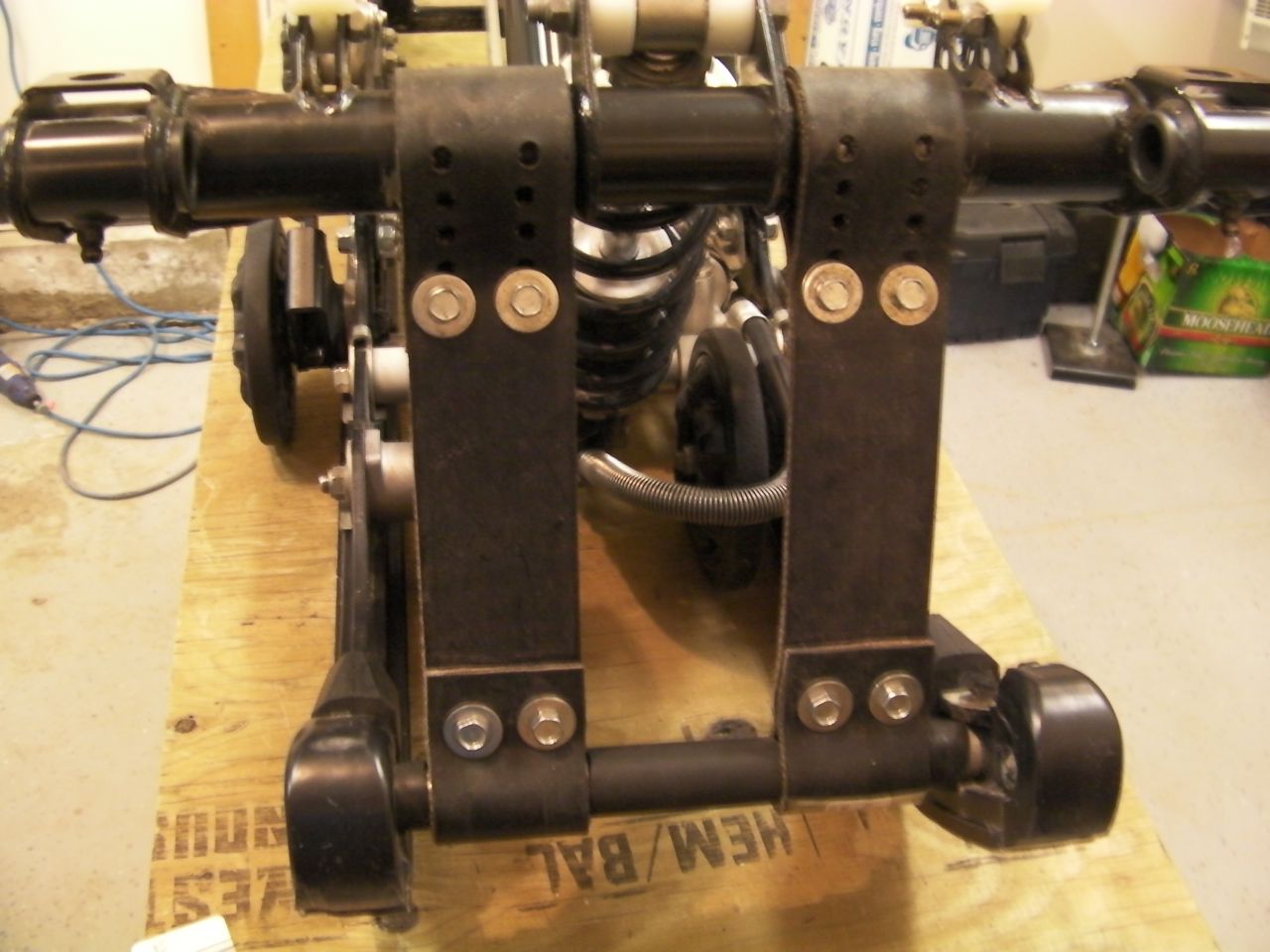

I ordered the Nytro straps from Royal and what they sent me was the 08 wide strap which is used as a single strap in the center. I tried them and they work pretty good, however mine is an SE and the XTX might use a longer strap.
