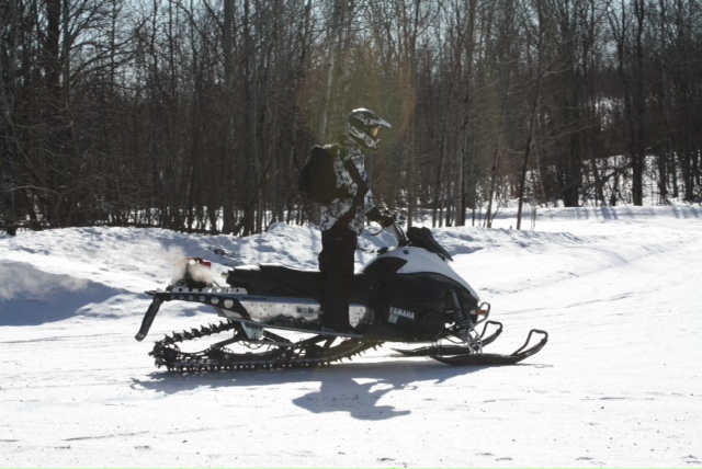

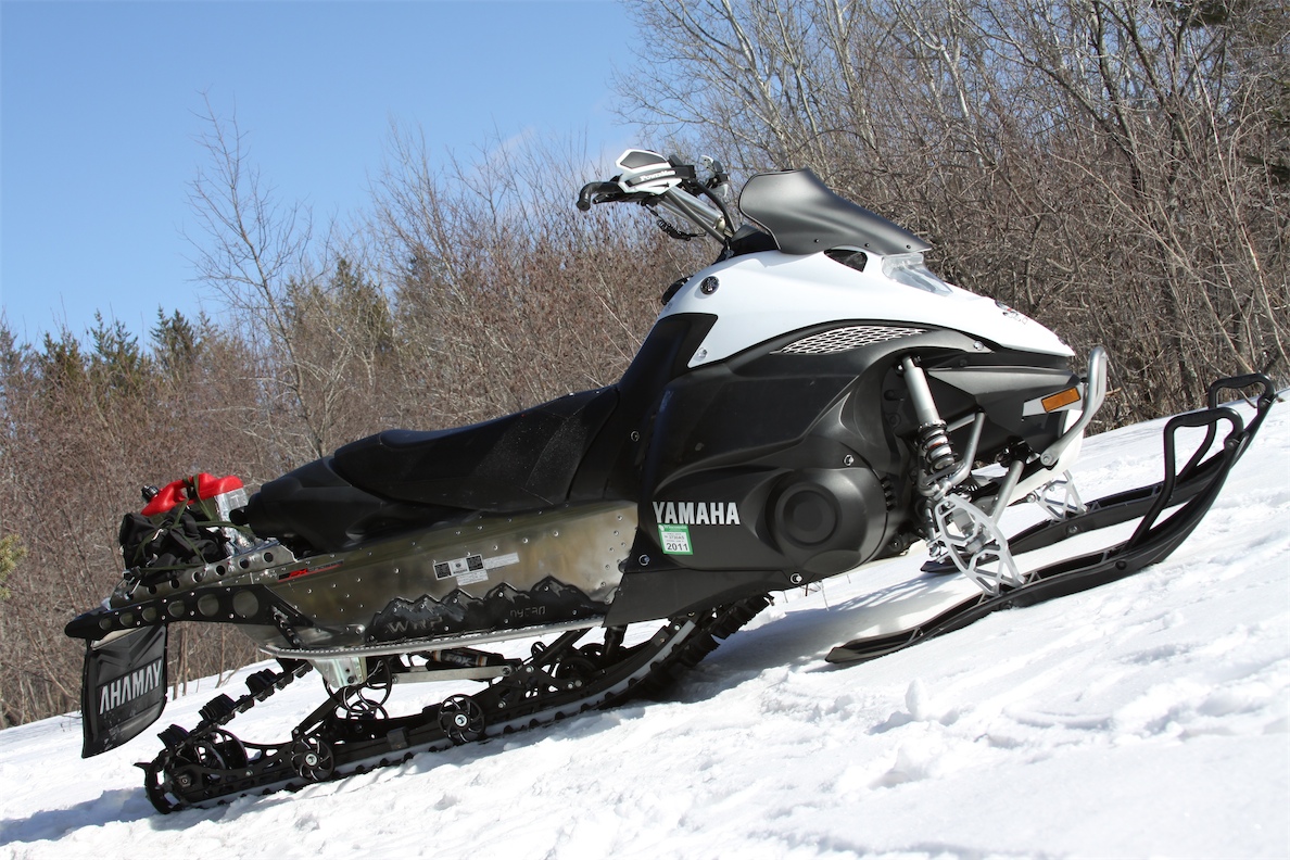

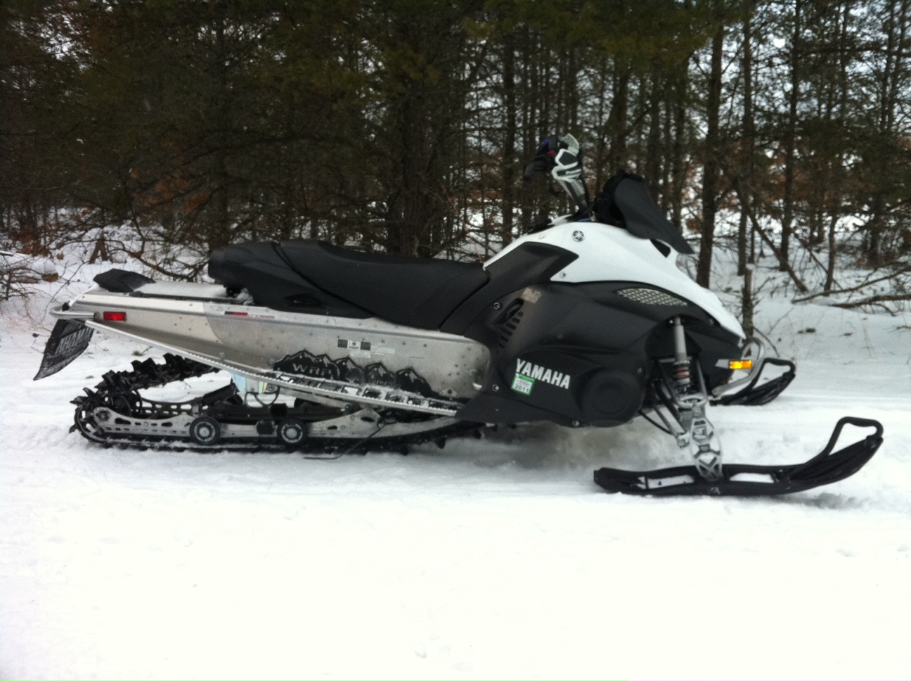

I did this on my old 09 153 as Stoli mentioned. It did bolt right in. Had the same questions and nobody seemed to have an answer, so I just bought a pulled out skid from someone who went TS and tried it. Didn't have an issues at all. Everything slid right into place.
There are a few pics in my older threads form about a year ago that show the change. I didn't do a tunnel extension either. As stoli stated, there was plenty of space left.

couple of pics - right after and then with further mods and skinz bumper.
http://www.ty4stroke.com/download.php?id=77128
http://www.ty4stroke.com/download.php?id=71182
http://www.ty4stroke.com/download.php?id=74747
