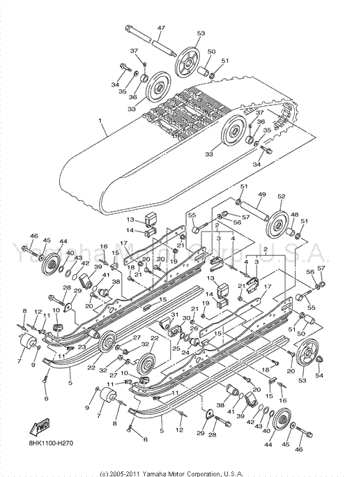

I need to replace 1 rear suspension rail on a 2009 RTX SE with the dual shock rear skid with the fancy clicker shocks. I have found a rail from a standard rtx of the same year.Only thing I see different is the RTX SE has the reinforcement plates (#17 in 2nd pic) bolted to the sides of the rails that the standard does not have . i can drill those holes easy enough.Does anyone know of any differences other than that ?

I think the rails are the same the se like u said have the reinforcement plates on the skid cross ref. the part #s for the rails from the rtx and se

No problem to use RTX rails. Just drill the holes you need. I replaced both rails on my 09 RTX SE with rails from a 08 RTX.

Yup, according to the microfiches, they are the same part number.
