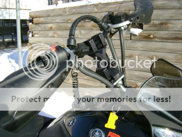

I got out for my first ride today after installing my relocator rollover valve and skidplate. Awesome stuff. The relocator makes the bars quite a bit higher. I can't believe that I am hearing myself say this but I think it might be too tall for me. I am 6'2". I like to do mostly technical riding and they seem a little tall. The improved steering is amazing. It's nice not to feel like I'm driving a bus.
One question Scott. Is that normal for the steering to be off a little after putting that kit on?

The easiest way to do it is to turn the front end of the relay rod ( heim joint ) in 3 turns.

Dang! I guess it helps to read all of the Instructions. Thanks for the great parts.
I'm 6'2" and am running the relocator with the stock mtx riser. I've thought about going up about an inch still, but after riding last weekend, I'm thinking of just leaving it as is.

184cm is just over 6 feet tall. You should be fine with the stock riser. I am 193cm and have the OFT relocate with stock riser. Just buy it, you'll love it!!

I think it will add more stress where it mounted. I have bent one already, but its an easy fix. The relocator is awesome. I'm 183cm and it is perfect

I'm 180 cm, or 5'11" and I like the Nytro MTX with the OEM riser and our relocator. I have since mounted an NCI riser that is 1" taller than the OEM riser with a pivot mount base this year, but have not ridden with it yet.
