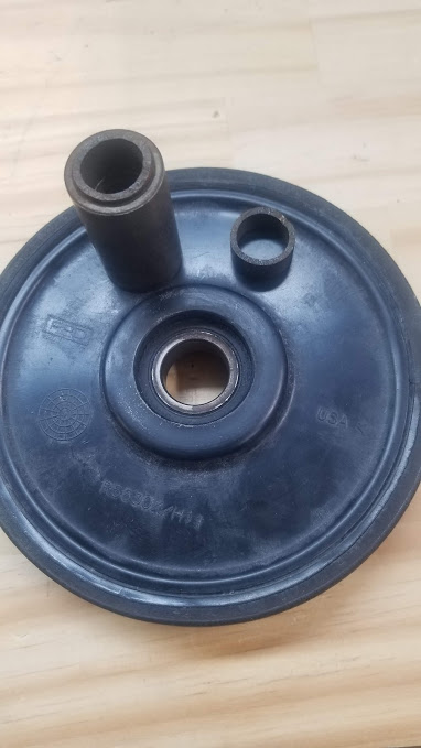

Another fun thing for everyone to look at: When I removed the rear shock from my sled, You have to remove the shaft below it that the rear idlers are attached to. Well when I removed that, some how the 2 spacer collars were both broke. Those are on back order till who knows when. So that will be a fall project. How do you even break those lol? (those 2 spacers in the pic were once 1 piece). No egg shaped holes. Bolts were tight. Very weird. Thanks again everyone!

. However the plastic bushing was still too short. I pounded the old bushing out of the old shock and pressed it into the extra space in the new shock and hacksawed off the excess. So I think I am good to go. Appreciate your quick reply Steve and for trying to see if you had a solution. This community is the best! Finally I can get these sleds put to bed and get the jet skis out of storage.Another fun thing for everyone to look at: When I removed the rear shock from my sled, You have to remove the shaft below it that the rear idlers are attached to. Well when I removed that, some how the 2 spacer collars were both broke. Those are on back order till who knows when. So that will be a fall project. How do you even break those lol? (those 2 spacers in the pic were once 1 piece). No egg shaped holes. Bolts were tight. Very weird. Thanks again everyone!
