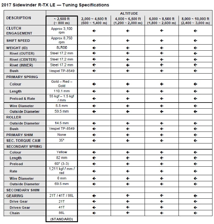

Same in '17 on Rtx/Ltx.....21/41 (dont see them changing gearing for '18)
Most of us go up to 22 top gear so not to run out of gear around 122 or so.(which comes fast with a tune)

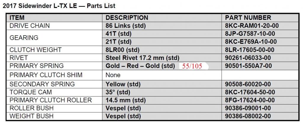

Ive attached some clutch tuning specs below as well....;)
Dan
