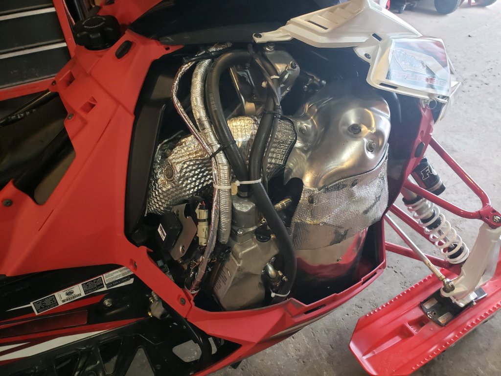

Trimmed around o2 sensor.

hmm it looks like you relocated the last screw for the heat shield mat as well. I'll have to take another look at mine. I appreciate the pic.

Yes sir. Made new hole for the aft bolt.
