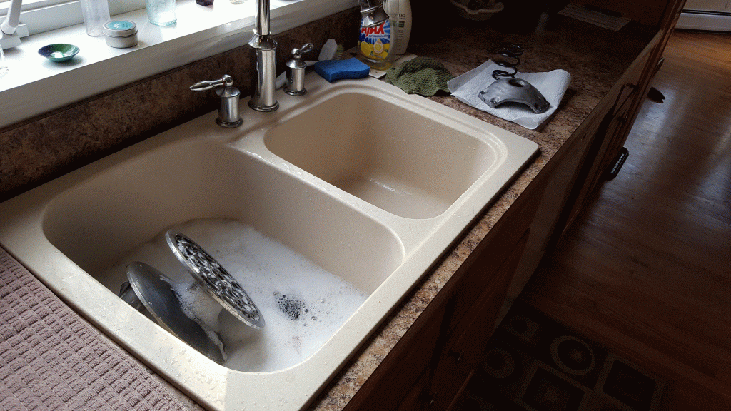

Hern... love the pic! Honey, I am just doing the dishes... : )

View attachment 133068 Clean the clutches and add a new belt. You will be very happy with the difference.
Pete
I do the same, then run the clutches through the dishwasher. [emoji106]
