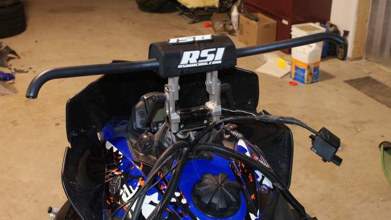

macpat said:how high are your risers?
What is the height difference between what you have done and stock?
I have never measured the difference, here are some photos of when I did the conversion, you can see where the steering post used to be in conjunction with the dash shroud. The RSI bars just feel so much better, as far as cable length everything is stock other then the e-brake cable witch is a stock cable off a Nytro MTX, it was the only cable that was tight.
