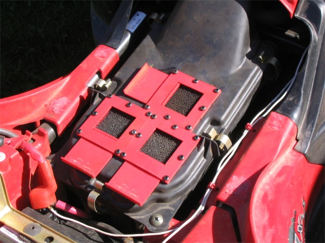

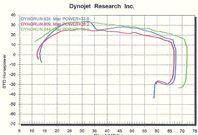

Chasis Dyno Results:
Run 009 with 26 HP to start w/ Stock Filter a HMF pipe
Run 044 33.6HP with mods below with HMF Pipe and open box lid
Run 024 33 HP is with my modded lid and I have made more changes but this gives you an idea.
I will try and get a stock number of a Grizz and my final numbers with tuning.

The 1.8 mph difference in top speed from the big bore tire change may be able to be overcome with more RPM on the bottom end by holding the shift back longer with the clutches. Note: Our Big Bore Grizzly does have fender flares and a 25 lb winch; therefore we feel just shedding those items could make a few more mph. Remember weight and wind resistance are enormous factors. Considering this, in my opinion, the gains that have been made are huge!!!!

Also attached is the Dyno Results prior to the final tuning!!!
