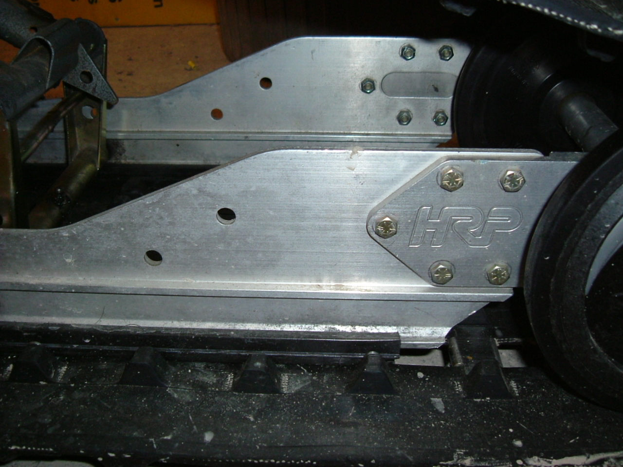

I migth have read this wrong about the holz. Brain dead momment, guessing its a holz skid that replaces the yamaha parts, but still uses the yamaha rails. If so, just get the end caps from your local dealer. Unless somebody say used a/c, doo, cat rails. Can you post of pic of the rear suspension? Or email to me, then I will be able to tell. Back in 03, holz didnt make rails.

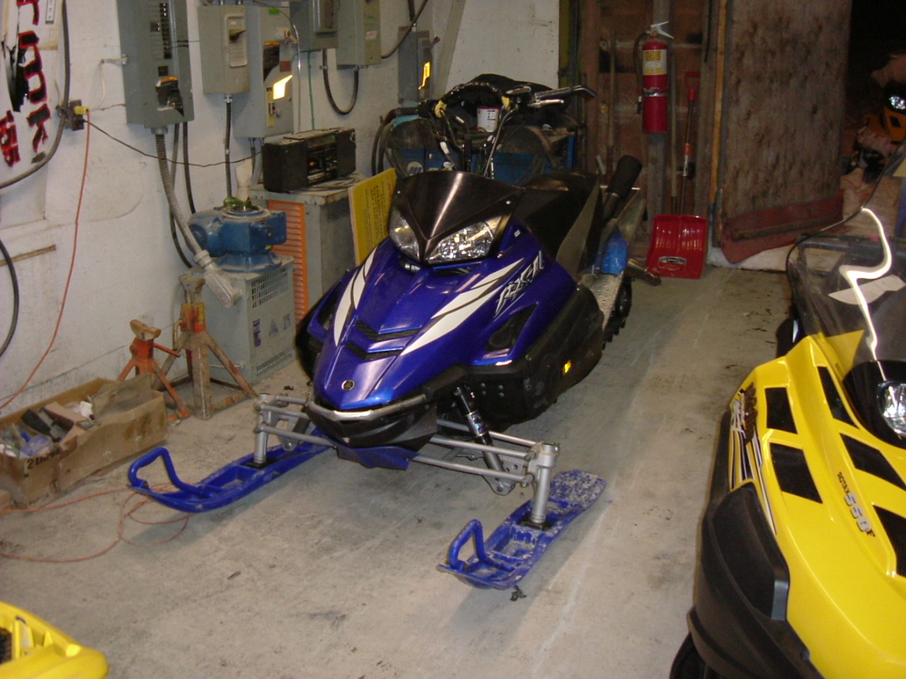

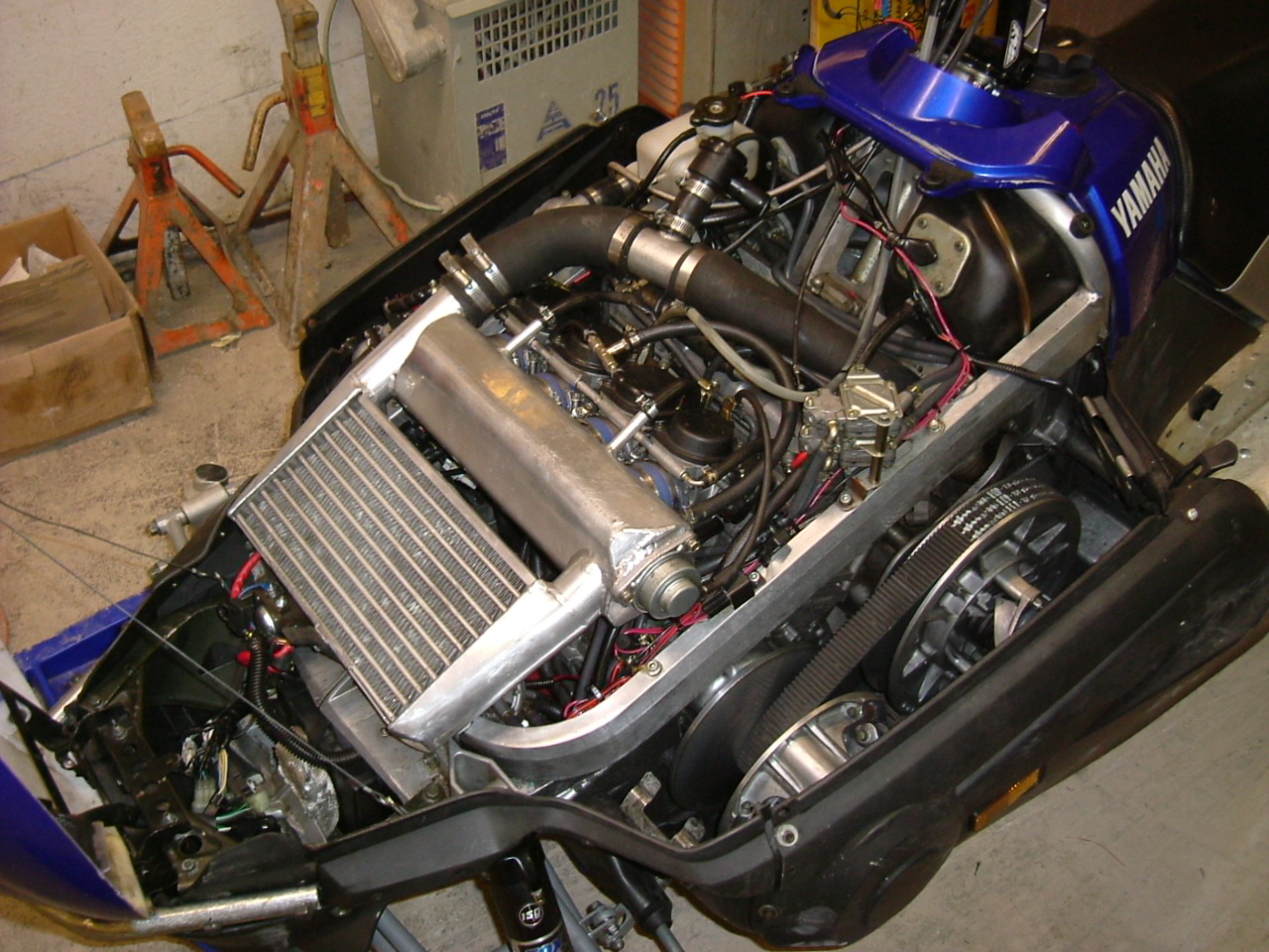

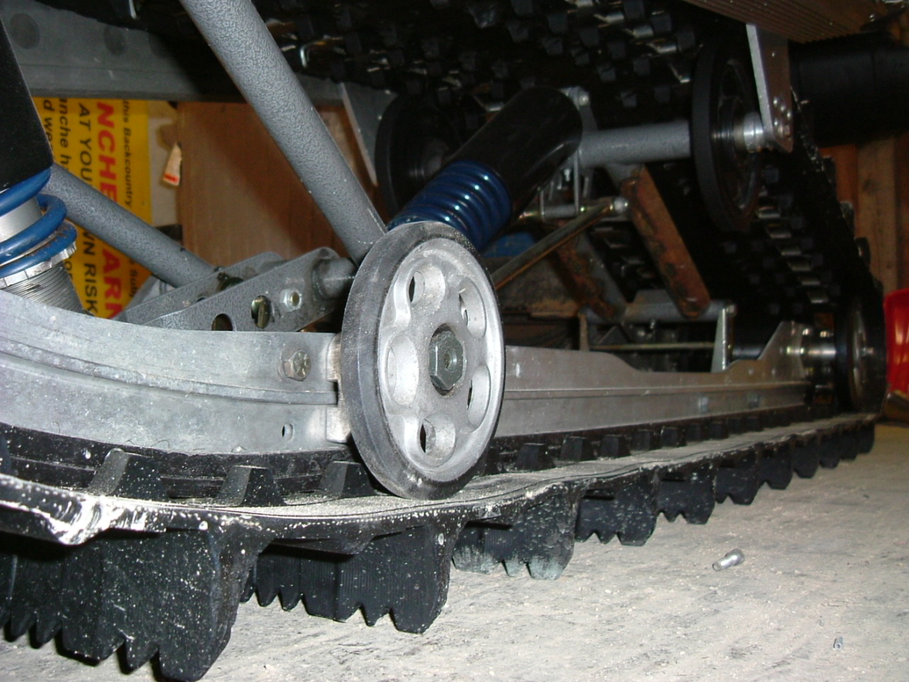

Here are a few pics to ponder. I see no HRP or Holz on the rails themselves. YES, that is a homemade front bumper and a Ford solenoid.

That sled is either a 03 or 04, just phone up local yami dealer & order yamaha rail caps. Those are yamaha rails, holz used to make a kit that helped keep the front end down. It mounted to the rear arm, mounted hortziontal, then you pumped the shock up/down as you like. Why are the stock fuel pumps still on? Image being a mcx, there is an electric fuel pump already.

Well, thats a good question. Im fairly new to the turbo thing, but it looks like there ia a vaccum or pressure (?) switch in line with the power supply to the electric fuel pump. Maybe it only runs the electric one when it needs it? Good news that its yamaha rails, with it wearing the front off like that I think I will build an anti stab for it, it will be quite stabbable with 3" pitch im thinking... Yep its an 03, 7500km, and thanks for the help.
Seems abit odd that there on the sled still. Guess if sled runs fine, might aswell leave them on. I know bender kits kept for a back up. This site is full of helpful people, image somebody will know why there. Do you know if the brgs behind the clutch have been greased or replaced? About the only thing that will give you greif, otherwise, great setup up you have there.
