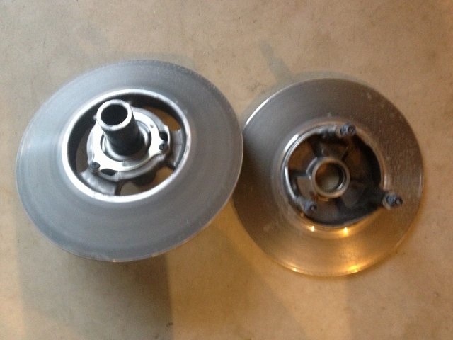

I changed my track out last season from the stock to a Challenger Extreme 162X15X2.5. That small difference in width really makes a huge change in handling. Much easier to pull over.
