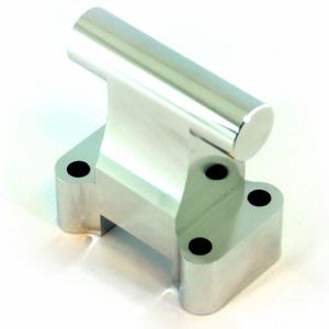

Here is the one I will probally end up with:
This one is from Lake effect:
Yamaha-Apex & Vector Pivot Adapter 3.0"
This pivot adaptor is made exclusively for your 2006 to 2011 Apex, Apex GT, Apex XTX, Apex MTX, Apex SE, Attak and all 2008 to 2011 Vector delta box II chassis Yamaha Snowmobile's. This adaptor allows you to retain the factory chrome beauty ring around the steering post. Made from 6061 aluminum and polished or anodized in 3 colors for your personal preference. (stainless steel fasteners included with your purchase).
Delta Box 2 Chassis seems to be differant?
Others claim to work for all current yamaha's and may but require modification.

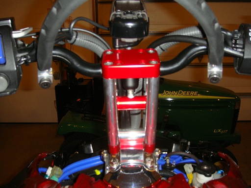

Yes, They seem the same until you get them apart and try to add or extend my current riser. I bought a straight 2 in from powermadd that stated it would work on all current Yamaha's 97 and newer?
in order to add the one I bought it will require 9 in metric bolts to replace the 7 in factory as I stated before. The new one will bolt on top of existing factory 6 in joint ( Riser I have) using original hardware. I can get the straight one to work but will have to drill out post convert to standard 9 3/8 in bolt and re tap or use lock nuts on the bottom of steering post plate.
The bolts are the main issueplus the fact that the powermadd product fit statement was not correct.
I want the end result to not only function but maintain the quality look!
Thanks Blue
Thanks Blue
