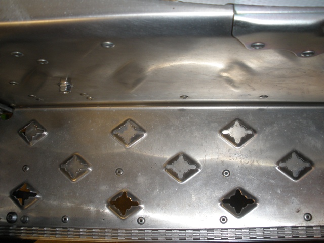

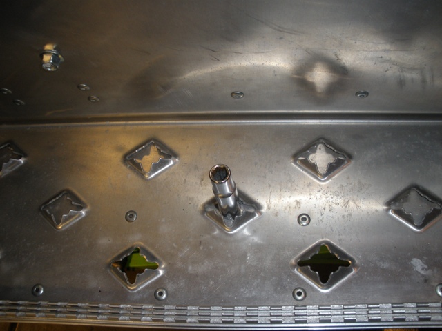

As I have been prepping my sled for the upcoming season, I noticed that there really isnt very many open drainage holes in the running boards. Since there is no heat exchangers under our running boards, snow does tend to build up and turn to ice. So I was thinking about drilling holes thru the reinforcement under the running boards to open up 6 holes per side for added drainage. I was using a socket to see how big of hole I could easily drill thru the reinforcement. It looks like I can drill 5/8" diameter holes.
Has anyone done this? If not, do you see any reason why I shouldnt drill some holes?
Thanks, G.B.

i noticed some improvement when i did mine. i didn't use a drill bit from top. i used a hole saw from bottom to cut out enough around the "diamond" hole.
Oh cool, I like that better as you can drill a bigger hole from the bottom side. Thanks to all for your input and suggestions!
G.B.

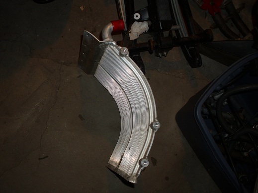

Phazer do have a cooler but its part of the tunnel. There is rivets holding it in place. It use to separate the engine bay and tunnel. Someone could remove it and replace it with sheet metal but I dont know how well the cooling system would work. It would eliminate icing there.
Others sleds have there addition coolers under the tunnel or running boards.
