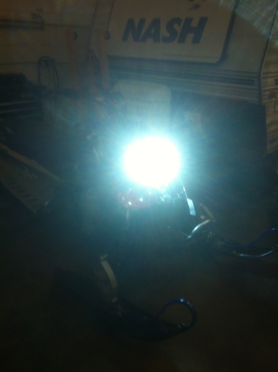

Here's my 2010 Nytro mtx 162 build. MPI says it takes up to 12 hour to install. i started the 1st of January and just finshed today. just working on it a few hours after work. i also did alot of other changes that was not in MPI instasll instuction that you will see in the pics. also put on a new ascent track, changed gears, put in a clutch kit, prologger dual temp, and removed the foam from the panels, also got DDMtuning H.I.D 1200k headlights.

did a test run outside tonight. every thing is running good. theys nytros really turn in to mosnters when boosted. once i hit 1/2 throttle the skis were no longer on the snow. they were like in take off mode. :nos on the prologger im hitting about 7 lbs of boost at 3/4 throttle. i have to break in a new belt, track, and s/c belt so i was taking it easy. my fuel ratio is alittle lean in the yellow mode on the gems so now i have to play with some settings once it warms up outside. :Rockon: :4STroke:
