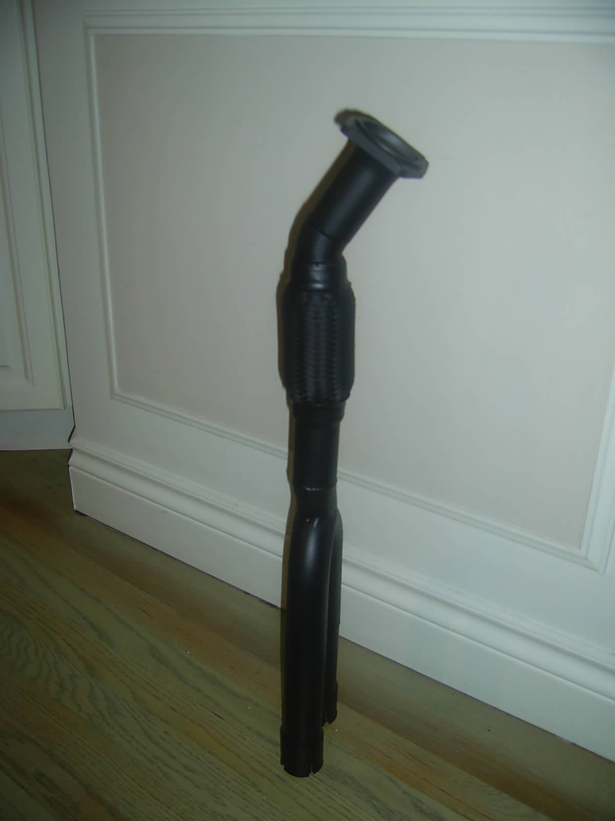

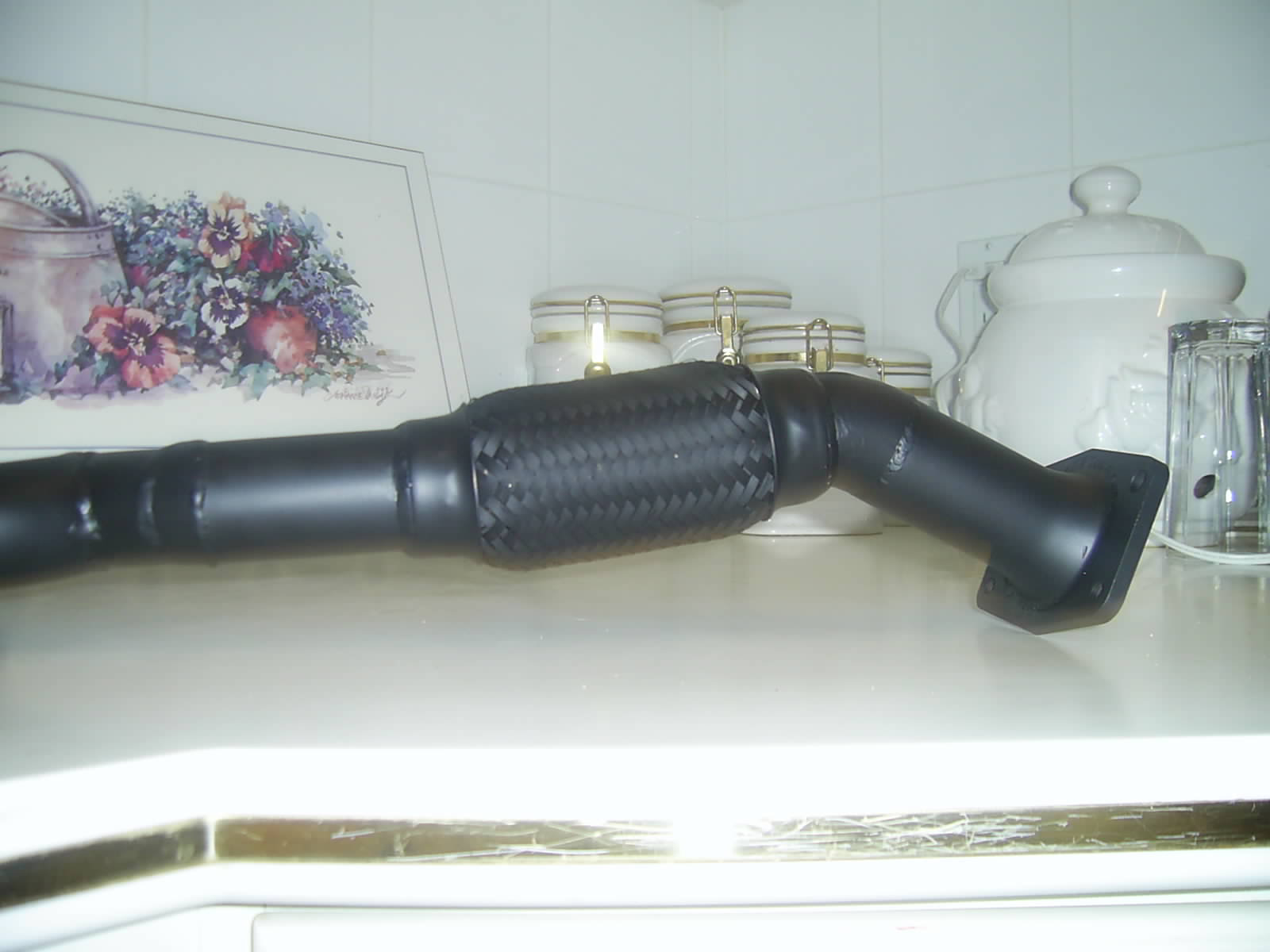

Finally got the pipe done guys.
Got the triple layer flex joint welded in to it. Got it jet coated, and ready to install. Thanks to lakercr for the eperimental pipe. And thanks to Jon at Atlantic Heat Coatings in Ajax Ontario for the great jet coating job. He's really excited because he has never done a pipe for a turo charged sled before. You guys south of the border don't know how lucky you are to have so many available vendors, when it comes to specialty work. Any way, it has good flex in the pipe now and hope to have some more pictures for everyone soon. If we get any snow this year we might have a year end report coming as well.

Looks pretty nice. Hope it works out well for you.

sledheadgeorge said:Finally got the pipe done guys.Got the triple layer flex joint welded in to it. Got it jet coated, and ready to install. Thanks to lakercr for the eperimental pipe. And thanks to Jon at Atlantic Heat Coatings in Ajax Ontario for the great jet coating job. He's really excited because he has never done a pipe for a turo charged sled before. You guys south of the border don't know how lucky you are to have so many available vendors, when it comes to specialty work. Any way, it has good flex in the pipe now and hope to have some more pictures for everyone soon. If we get any snow this year we might have a year end report coming as well.
Looks good George, glad it worked out for you. When will it see the snow?

Going north tonight. Hopefully it will be ready by the morning to try it out. lakercr I like the extra length of the pipe at the "Y". I think it is better than MCX pipe. Reason being is that the MCX pipe at the "Y" is much shorter and holds more heat at the joint. Its good to hold the heat in the pipe but if it is too much could result in some damage at the joint like I had. I will let everyone know how it works.
