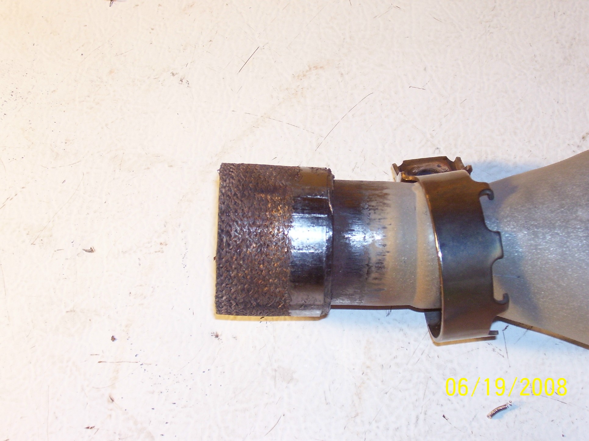

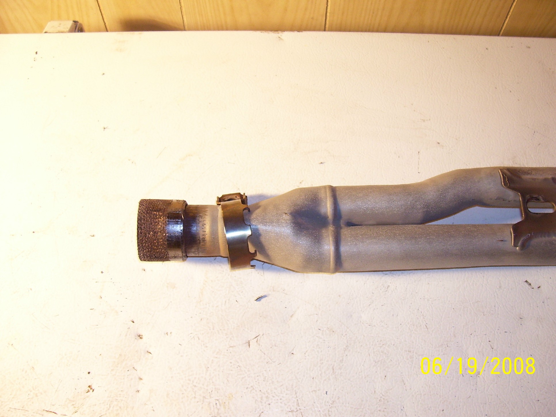

I think I may have found it. I replaced these exhaust doughnuts on the headers 2 rides ago Did I put them on backward? They are burnt out again already after 2 rides...At least it looks like they are to me? Could this be causing me to only build 14 psi?

Yes you did, they're backwards, no doubt about that. They may not seal up very well like that.
Thanks, hopefully that was it!
That was it! Thanks for the help.
