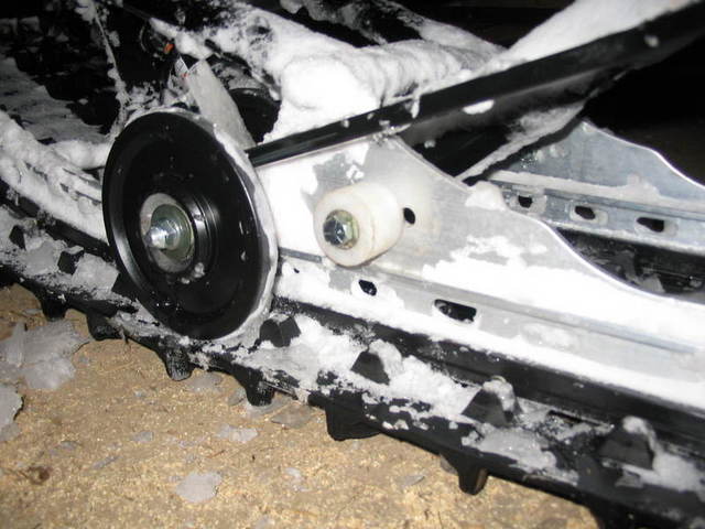

pat the rat said:here's a pic,made them myself by the way
does it work well?
