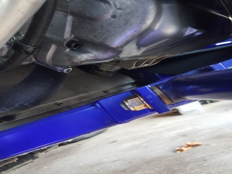

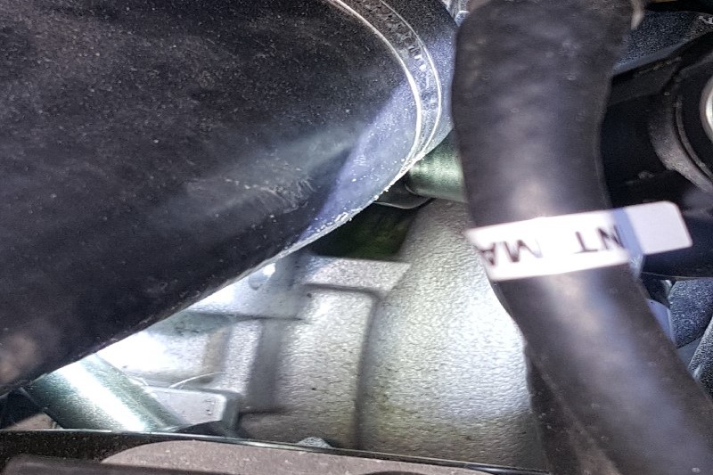

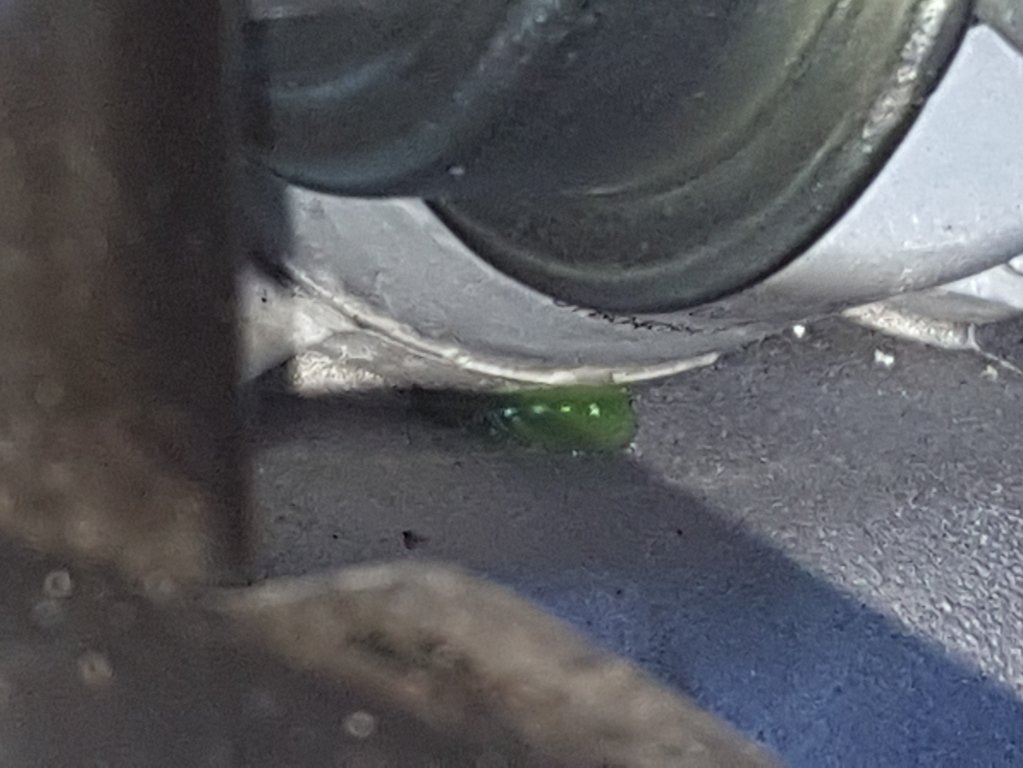

Can someone help me figure out where this antifreeze leak could be comming from,this is the oil cooler front center of engine there are drips on the bottom right side of the oil pan when wiped off they come back the next day the sled hasn't ran since august.
There is another puddle in an engine cavity dirctly below the cold side of the turbo to the right and up from the oil cooler

Try tightening the coolant hoses that go to the oil cooler, mine were leaking from loose hose clamps.

Hi, do you ever find out where the leak was coming from? I have a similar one. Coolant under oil cooler then drips down engine. What it just the hoses entering or exiting it? Thanks

I’m going to try that. Was just hoping OP would say what worked for him.

2021 srx , first oil change same leak as my 2018 , clamp right above spark plug cap leaking. Not a big leak but it’s dripping

I brought it to the dealer under warranty they said every hose clamp was loose i only went for one ride so far seems okHi, do you ever find out where the leak was coming from? I have a similar one. Coolant under oil cooler then drips down engine. What it just the hoses entering or exiting it? Thanks

Why didn’t you just tighten clamps yourself after asking for suggestions and receiving them 4 stroke guru.

Because i never had the room in my garage and have 2 years warranty left amything else?Why didn’t you just tighten clamps yourself after asking for suggestions and receiving them 4 stroke guru.
Ok. Thanks for replying. I tightened up most hoses on the sled when I first bought it but never did the two going into the oil cooler. Tightened those up and started it up a couple of times since then. Don't see any leaks.
