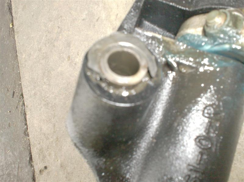

This is what I found on dis-assembly, the left side was perfectly fine.
