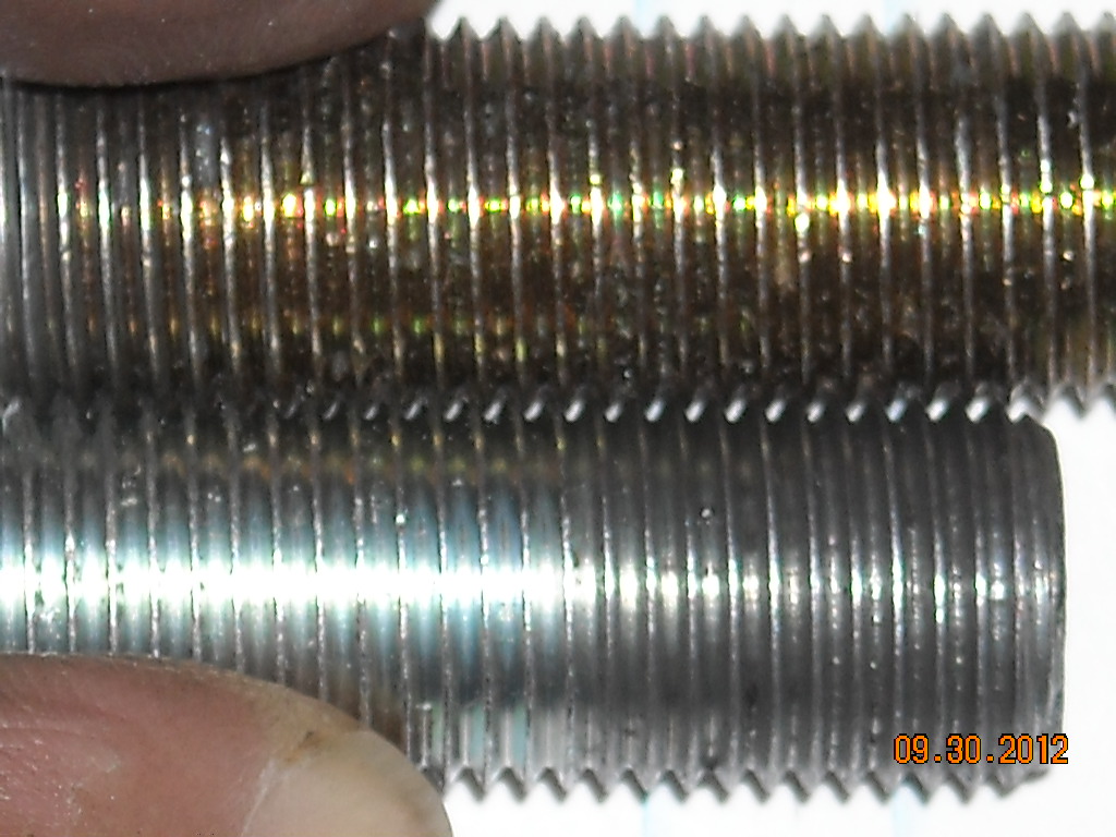

Sorry to disagree. Here is a picture of both bolts. You can see that the threads do not mesh.
The 1/2 -20 bolt will thread into the crank by hand for a few threads only. The thread pitch is CLOSE but not exact. The Yamaha bolt will thread in much further by hand because it is the correct pitch.
This is a photo of a known 1/2 - 20 bolt matched with the bolt supplied by CV-Tech.

You're posting incorrect information that might prevent someone from buying a PB80.Sorry to disagree. Here is a picture of both bolts. You can see that the threads do not mesh.
I know the supplied PB 80 bolt works. No issues.
