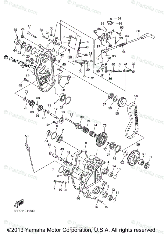

Up north in Wisconsin a couple of weekends ago. 2009 Apex ER. Shifted into reverse, made horrible grinding noise, would not move. Shifted back into forward, worked fine. Reverse again, same bad noise. Upon disassembly, the bolt, number 63 on diagram, was broken. gears were slightly chipped. Has anyone had this bolt break before? Is there something else to look for. Driveshaft bearing on opposite side of drive shaft is good.
- 5,721
- 4,312
It's common for that bolt to break. Yamaha again made a change to the driveshaft in 2011 or 12 and also to the #80 in the pic.
I would just put a new bolt in and drive on. Sounds like your linkage freeplay may need adjusting also.

Thanks. Linkage adjusted. Bolt replaced. Hopefully all good to go. Wondered if that bolt break was relatively common.

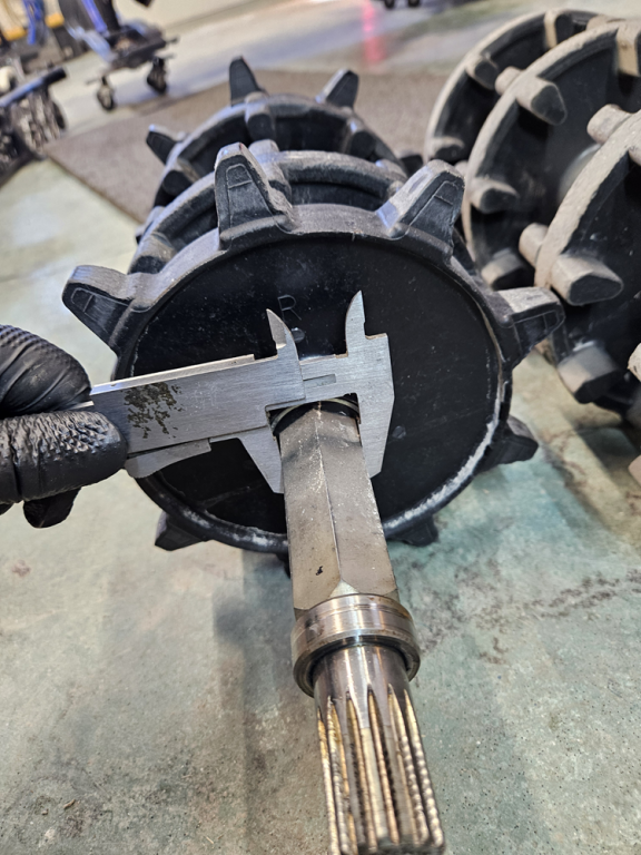

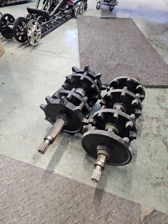

Just did a track change on my Attak. I have been using a 2011+ jackshaft that I got from BoP. Travis machines newer jackshafts to fit the pre 2010 chaincases. Here you can see how much thicker the newer shafts are.

Awesome idea.Just did a track change on my Attak. I have been using a 2011+ jackshaft that I got from BoP. Travis machines newer jackshafts to fit the pre 2010 chaincases. Here you can see how much thicker the newer shafts are.View attachment 179963View attachment 179964View attachment 179965
