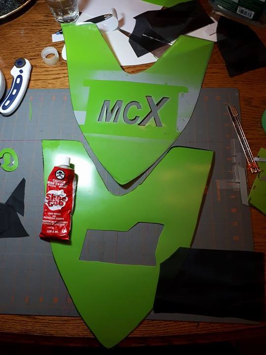

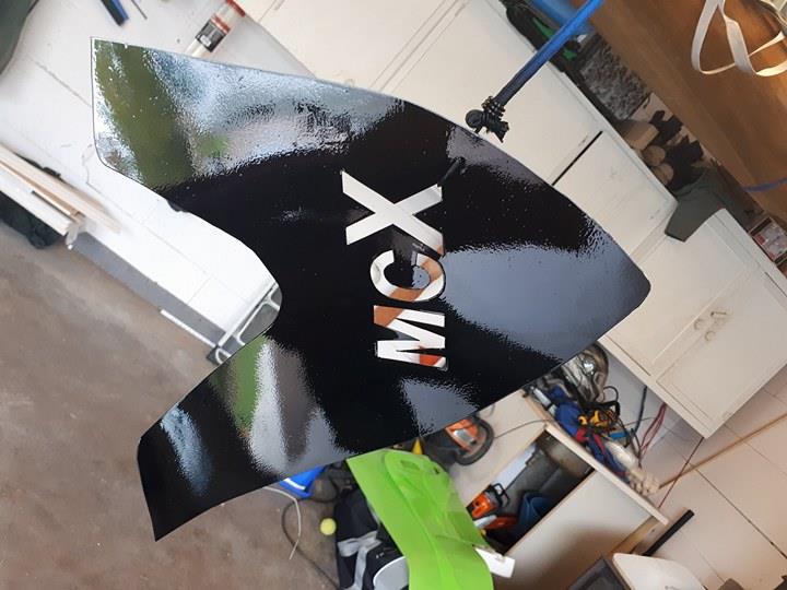

After seeing the price tag of a ram air box cover I decided to make my own.
Cut open stock cover and used crazy carpet plastic with Outerwears pre-filter material. 2 layers of plastic with filter glued in between. Sealed on and rivited to cover.installed a few LED strips in box for cool look. Not 100%completed, still want to put a plastic folding over the rivets.
