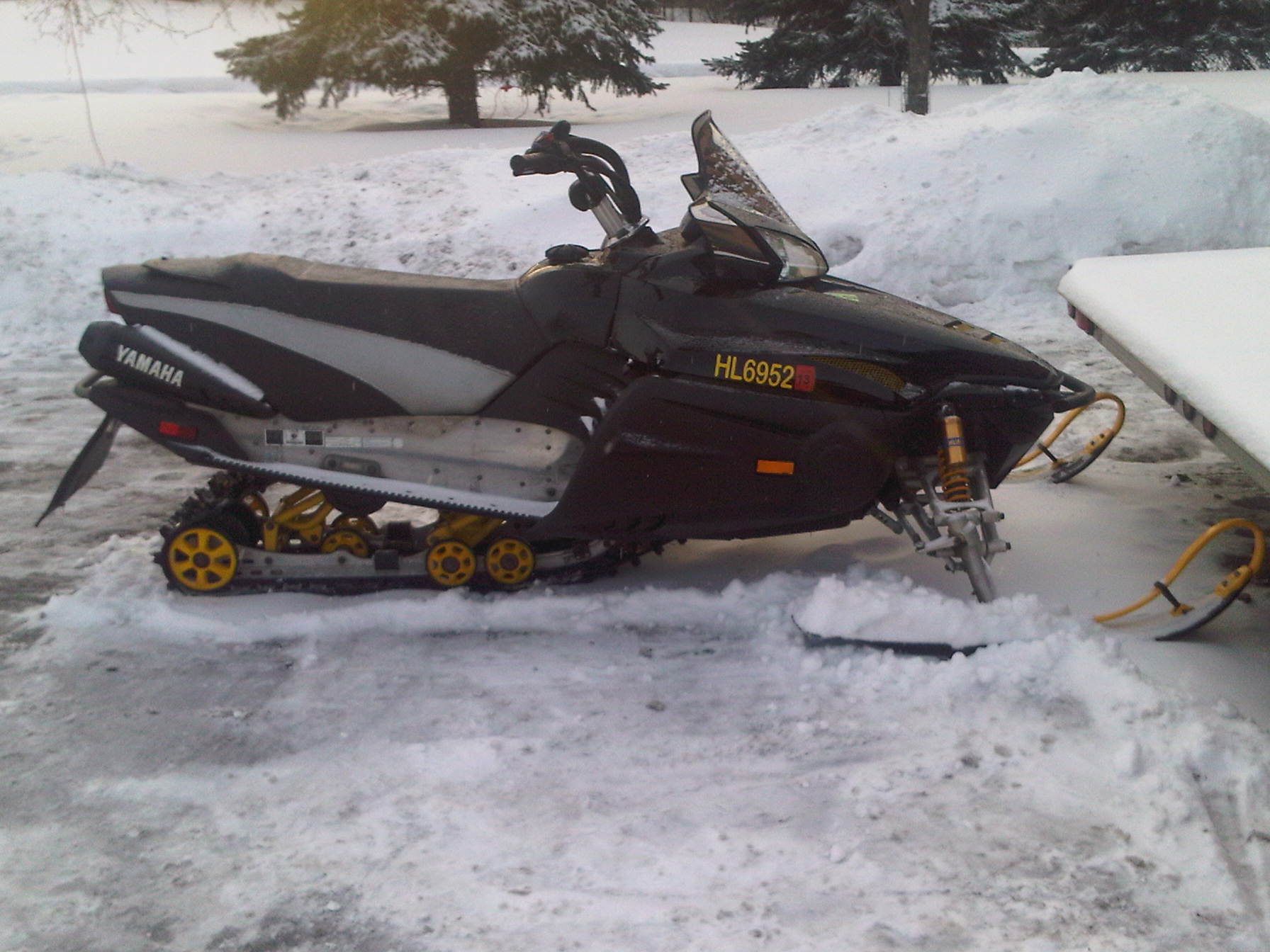

yamadog what bars and riser set up do u have on there?
Those are stock 05 bars the rest is all off an 07 attack 6" riser and trim ring I had to change over to mountain cables to get the length to make it work.
I used door edge protector from pep bouys to finish the trim to the tank cover hole.
