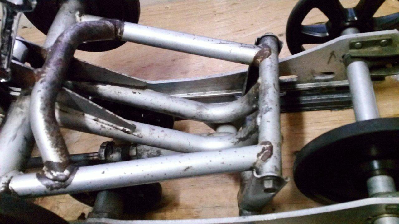

Now I have pulled my 9700 mile skid out of the Apex GT and prepping it for Half-baked beef up kit and powder coating. I'm having one issue and it is getting the upper track guide wheels off of the suspension component.
For the life of me, I can't figure out how these come off. They look like they are pressed on, and maybe some WD-40 will loosen up their grip on the shaft, but I was unable to make them budge.
As you can see from the rusty welds, this skid is overdue for the kind of TLC that Half-baked can give it.
Your help is always appreciated. Thank you!

I use a block of wood and a large hammer. Place the wood on the floor. Place the axle verticle on the block of wood. Now with the hammer, bang on the wheel (near the bearing race) that is closest to the block of wood. This will usually knock the bearing race free of the axle. When I get a real stubborn wheel I remove the C-clip that holds the wheel on the bearing and then knock the wheel off the bearing and then deal with the bearing itself.
Soaking the area with penetrating fluid will help as well.
Good to hear. That is what I was doing, but I was thinking that I was trashing that wheel. Neither side seemed to budge.
So it looks like I will be soaking that area with WD-40 then and working on it some more.

Screw the bolt back into the threads about half way, tap on the bolt with a rubber hammer, should slide the shaft out, do this on both sides one side at a time though.

We await your parts.. if you have an issue getting the wheels off we can do that for you.. You will however need all new bushings unless you just replaced them.. (doubtfull) lol

Even after sitting overnight, those suckers still didn't come off. Brian at Half-baked said he should be able to get them off. My guess a torch will probably be needed. Better have a fire-extinquisher close Brian, as there is plenty of flammable stuff on it!!
We will see how this goes as Half-baked should see the parts tomorrow. I have already placed my order for replacement bushings, rivets and one new rail cap as I sacrificed one while trying to drill out the rivet. GRRRR!

It's too late now.. but for the future.... Screw the bolt back in the shaft on one side. Put it in a large vice horizontally so the jaws are at the back of the wheel. You can now use a good size hammer to pound that wheel off the shaft. (You are actually pounding the head of the bolt so the shaft is moving off of the wheel) Once one side is off you can just slide the shaft out the other side so you don't have to remove that wheel. These can be a pain.
