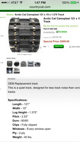

Keep in mind the pitch of the track you are considering. I think it's a fair guess that you are looking at an Arctic Cat track with those dimensions. Aren't cat tracks a different pitch than Yamaha? Listen to the other guys and find a 2.52 pitch and save yourself the cost of new drivers as well.

Yup, that's 2.52 pitch
The original track you had asked about was a 13.5" track. Not this 15" track
But after further research, the old 128x13.5" were 2.52 pitch as well.
The track above would be a better choice over a 128x13.5 too
That the track Im thinking about geting
