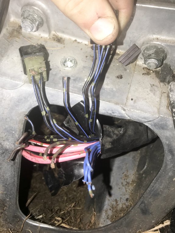

Mice chewed up wiring in front bulkhead.
I have 5 blue wires that I can’t see the ends of where they went.
2 brown that need to splice together,
And 2 blue/black that meet to go into a some connector where they were chewed off from
anyone able to help please?

Sounds like you need a service manual and wire diagram.
I have power to the dash now, fuel pump working, no start. I have an 11 and 22 code showing on the dash. No clue if the wires are right. I wired the 2 brown together, the 2 black/ blue to the plug, and the 5 blue all together. thanks for your help guys.
I would do the ground wire mod. I had a similar issue and it cured it and no issues since. You basically cut and solder 4 or 5 wires into 1
I wired 5 blue together, 2 browns together, and the black/ blue together. I ha e dash lights and fuel pump working. It turns over well. Still no spark. Pulled a plug and no spark, unless it’s not grounded well enough. I have 3 codes.. 11, 21, 22.

I don't know if it helps anyone, but I ended up replacing my whole wiring harness and also starter relay housing, and it fired right up. Even with the wires that were cut spliced together on my old harness, I couldn't get it to have spark. The new harness cured all. Now I have a coolant leak at the rear heat exchanger in the pipe right before the hose. :(
